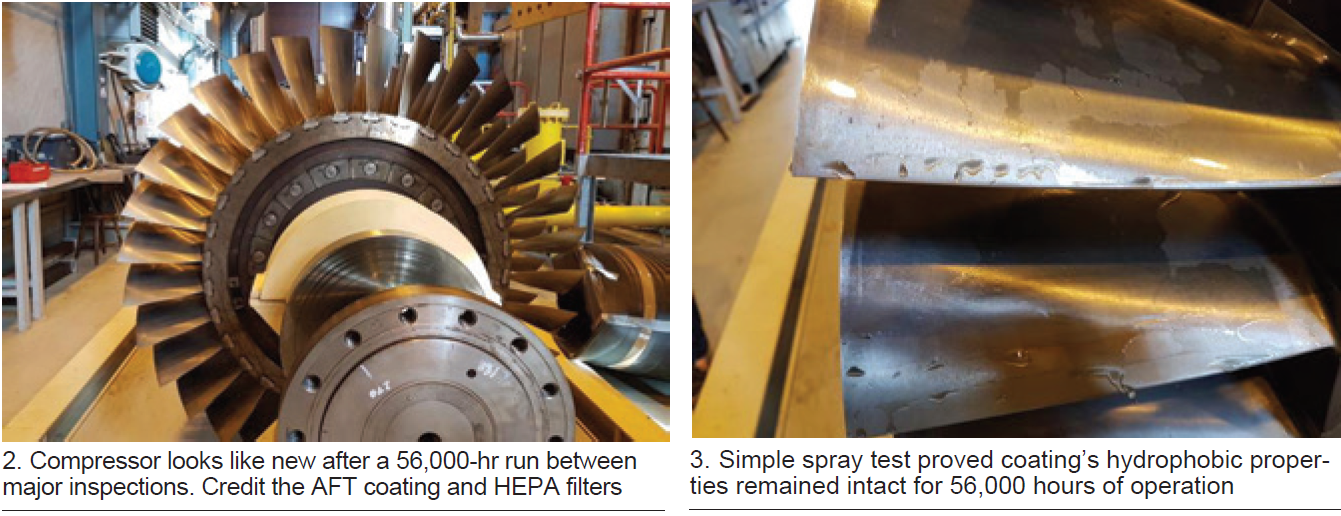

The stainless-steel compressor blades were cleaned and coated with the anti-fouling treatment AFT from United Services Sweden AB during a major overhaul in 2011. No fouling-related degradation was in evidence after 56k hours of operation (seven years) with annual washing only (Fig 2). The photo shown in Fig 3, taken after spraying water on the compressor blades, shows that the coating’s hydrophobic properties remained intact.

The editors communicated with the plant manager (PM) by email to get the details that follow. The plant learned about United Services’ coating through discussions with other users in Scandinavia. One member of the collaborative group of owner/operators had used the coating on his IGVs with positive results. The PM said he reviewed that experience, as well as laboratory test runs, before putting AFT on IGVs and first-stage rotating blades of his 6B about three years before the 2011 major. His trial showed that fouled airfoils were cleaned simply by washing with demin water.
United Services both cleaned and coated the compressor section in the plant shop without removing blades from the rotor. This work took four days and had no impact on the outage schedule.
The PM said he expected the coating would retain its dirt-repelling properties for the entire period between consecutive majors and that was confirmed by inspection. However, an additional coat of AFT had been added to the IGVs and first-stage blades after a couple of years of service. The recoated rows were viewed as easier to clean with demin water (no soap).
Compressor performance degradation was said to be “considerably less” after the coating was applied and air inlet filters were upgraded. The PM said the 4-MW loss experienced between annual shutdowns with uncoated blades dropped to 1 to 1.5 MW after coating and installing filters offering more efficient capture of fine particulates.
