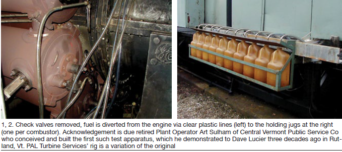

GE control specifications provide valuable information for testing at firing speed. For a Frame 5L operating at 1000 rpm, expected fuel flow from the flow divider to the 10 combustors is 2.2 gpm. This means each combustor should receive 0.22 gal (approximately one quart) for a 60-sec firing attempt.
First steps: Remove all 10 check valves from the engine and divert fuel flow (Fig 1) to the test rig (Fig 2). By re-routing fuel via the clear plastic lines, the “false firing” attempt will collect all the fuel. Without check valves, fuel pressure is negligible. Safety tips: Disconnect spark plugs and flame detectors before the test. Also, warn personnel that the CO2 fire protection system remains charged in standby.

1. Start the gas turbine with selector switch 43 in CRANK and run up to 1000 rpm.
2. Confirm firing time is set for one minute on timer 2F.
3. Move the switch to the FIRE position, and time for 60 sec using a stopwatch.
4. Fuel is diverted to the 10 jugs shown for the “false firing” period. The fuel flow expected is 10 × 0.22 = 2.2 gpm. Thus, each container should collect approximately one quart of fuel. Final step is to empty the fuel lines into each jug. Note that the expected maximum rated fuel flow with the engine operating at 5100 rpm is 37 gpm.

In conclusion, the value of this test is in confirming that the fuel pump and flow divider are working properly. The check valves removed should be disassembled, cleaned, reassembled, and tested. Electricians should test the spark plugs and UV flame detectors.
This definitive test is easy to perform and produces indisputable results. PAL Turbine Services recently brought its test rig and a spare fuel pump to a Frame 5 outage in Pennsylvania. Good thing. The existing pump was tested and found lacking in fuel flow at the 1000-rpm firing speed. It was replaced with the spare (reconditioned) pump and tested before system recommissioning.
