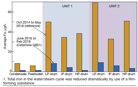

The presenter reviewed monthly data for pH, phosphate, degassed acid conductivity, total iron, and carryover. Total iron in condensate showed a significant drop, as did total iron in LP and IP drums and in average values for both HRSGs (Fig 1).

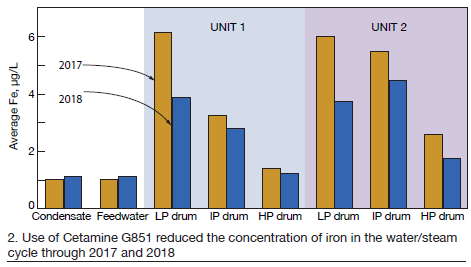

Additionally, water/steam chemistry analysis showed a further reduction in iron during Cetamine G851 treatment in 2017 and 2018 (Fig 2). Carryover dropped significantly in 2017.

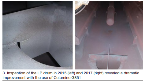

Inspection photos supported the findings (Fig 3).
