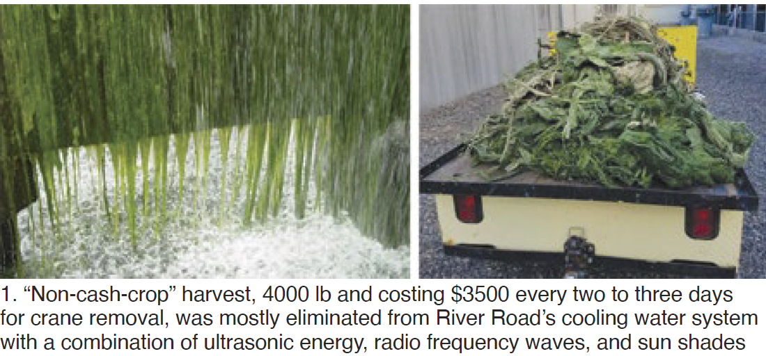

A combination of ultrasonic energy, AM radio-frequency waves, and sun shades managed to tame severe algae growth in the cooling tower at River Road Generating Station, according to Operations Manager Justin Hartsoch, GE Gas Power O&M. He told participants in the 2021 conference of the Combined Cycle Users Group (virtual) that algae blooms became a problem after the plant was compelled to shift from chloride to a bromine-based treatment to meet EPA NPDES regulations.
In a moment of levity, Hartsoch called the collected algae a “non-cash crop” (Fig 1), but also noted that the plant’s “unique algae bloom is seasonal.” Well water is the source for the plant.
The biocide formula that was being used also fed on silica, creating resistant algae which would coat the forebay trash screens, and require cleaning every two to three days. So, the plant undertook a campaign to identify a non-chemical approach to algae control. The solution to date (“the story is not over,” Hartsoch said) has proved to be the following:
    • Adding floating-head ultrasonic transducers at key locations throughout the cooling-tower basin.
    • Installing nursery sun shades on three faces of the tower to deprive algae of the sunlight necessary for growth.
    • Installing radio-frequency devices on each of the circulating- and service-water lines.
Details of this unique cooling water treatment approach, the theory of design, the circumstances which led to it, and the subsequent results and benefits were reported last year in CCJ. In the CCUG presentation, Hartsoch did note that the payback was a year and a half.
