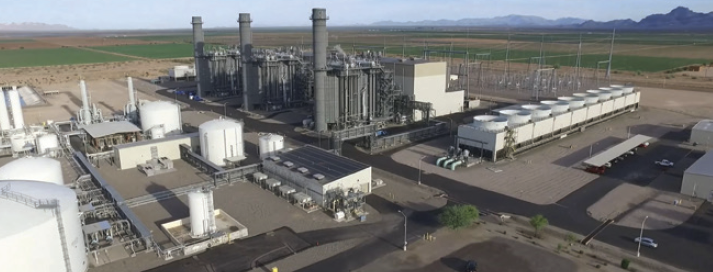

1080-MW, gas-fired, three-unit, 1 × 1 combined cycle located in Tonopah, Ariz

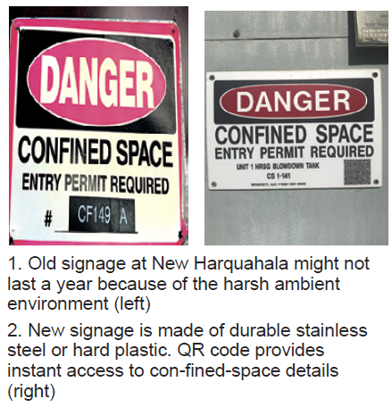

Challenge. The confined spaces at New Harquahala Generating Station were identified and numbered a few years ago. It appeared that during the initial project, the numbering and identification were likely rushed, and the numbering system was labeled haphazardly from unit to unit. While there was the same number of entrances on the units, the numbers did not match up from one unit to the next.
Employees had to pay special attention to which unit’s information was pulled to identify the space and the hazards associated with it. Employees tried to fix this over the years, but there was still much to be done. Three key issues were found in connection with the confined spaces.
First, it was brought to the safety committee’s attention that employees believed some of the confined spaces had been misidentified and some completely missed. Also, numbering of the confined spaces did not match from unit to unit. The safety committee wanted the job done correctly and in a manner that would last a significant amount of time before needing much work again.
Second, the labels on the confined-space signs, along with a few missing signs, would fade and tear before they were even up for a year or two because of weather damage. The safety committee recognized that the current confined space signs, as they were, could not hold up to the elements of extreme heat conditions and the direct sunlight they were receiving. Something had to be done.
Third, the current computer program was not easy to change and/or add confined spaces to it. A list was compiled in Excel that identified the current confined spaces and the confined spaces that staff believed had been misidentified (multiple access points and/or levels) or missed entirely. The safety committee also wanted a new numbering system put in place for the confined spaces that included the missed spaces. They could then align the confined space IDs on the units so they matched.

Phase Two was a thorough and careful examination of the facility and each confined space already identified and then to identify any space missed. The locations were documented and numbers assigned to each confined space. Stainless-steel signs were specified for areas with high heat or sun exposure; hard plastic for areas better protected from the elements (Figs 1 and 2). The signs include a printed label with Quick Response (QR) codes.

Results. Revamp of the confined-spaces portfolio created a better system, one much easier to identify the confined space and the associated hazards. The identification numbering system was redone so that each unit’s identical confined spaces now match from unit to unit.
Signs were printed on the metal backing to ensure they would withstand the Arizona sun and heat through more than a year or two, making it easy for all to identify the confined space. Signs include the appropriate QR code, helping employees and entrants be better prepared for the hazards they might encounter upon entering the confined space.
