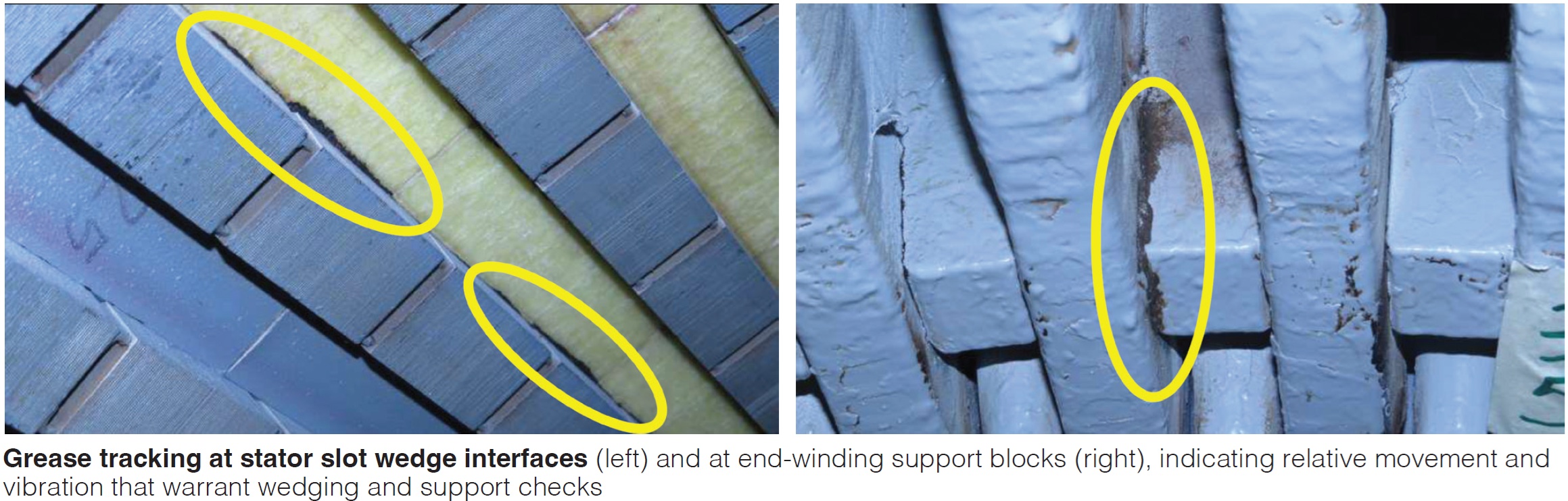

A full diagnostic suite found a fundamentally sound stator with localized issues. Insulation resistance exceeded 100 MΩ on all phases. Polarization index was roughly 3.7 to 4.7. Dissipation factor change and tip-up were less than 1 percent, which is consistent with healthy epoxy-mica insulation. Offline partial discharge identified one phase with the highest activity. The TVA probe crossed typical thresholds in three slots. The UV camera showed weak to moderate corona at two end-winding sites near grading. ELCID was clean at less than 100 mA. Visuals showed greasing at wedges and minor rub marks at end-winding supports (Figure).
Actions for the outage were direct:
  • Repair the two corona sites
  • Plan a wedging-tightness survey when the rotor is out
  • Repeat the offline suite in five to six years
  • Add semiannual online PD trending
The practical takeaway is that small, targeted fixes now prevent nuisance trips and protect against an early rewind.
