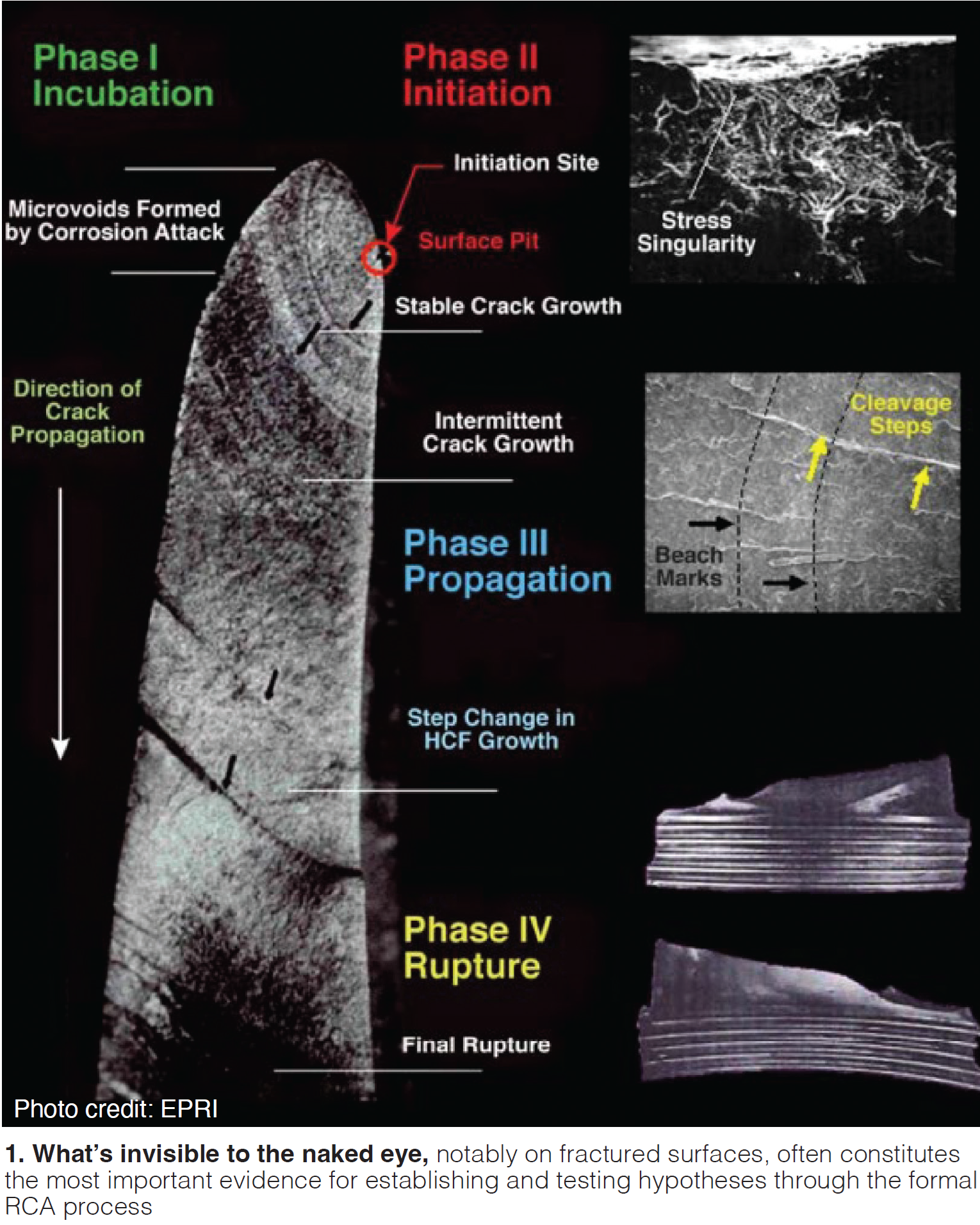

When it comes to expert analysis of broken components, there is a wealth of information contained at the microscopic level on a fracture surface. This type of evidence will likely become evident only with laboratory analysis and instrumentation (Fig 1), and is susceptible to being obscured or even lost if not handled properly. In addition, “spoliation of evidence” (loss, destruction or alteration of evidence resulting from a party’s failure to preserve) becomes a legal liability.
  • Tip #2: Do not try to “fit” fractured surfaces back together, as this can damage or even destroy the microscopic features of interest to experts investigating failure mechanisms.
Broken pieces should be packaged in ways that avoid surface rubbing, impacts, or environmental exposure which may lead to corrosion, for example. Use gloves when handling evidence and bag all pieces separately.

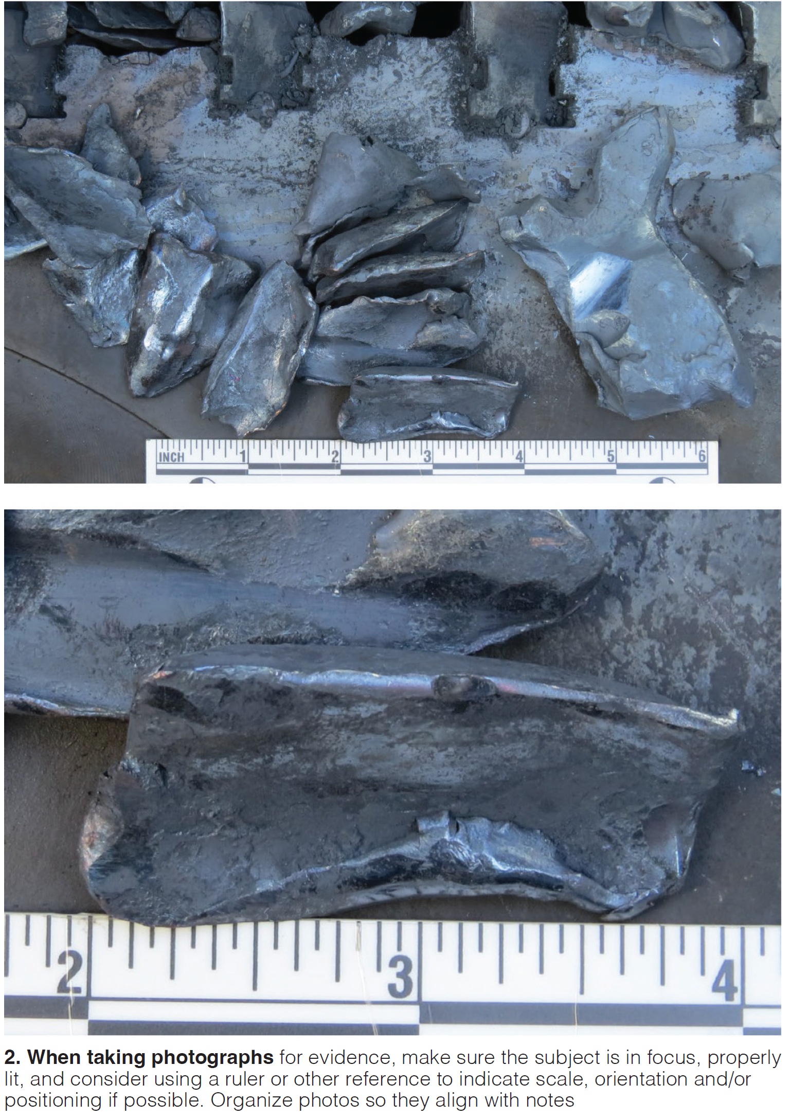

Photography skills is one area all plant staff can train for (Fig 2). Here, you can take a cue from your social media. Lighting is key! Include photos from multiple angles, far away, and up close. Again, more is better.
  • Tip #4: Take photos in an order starting on a large scale and then zooming into smaller details in subsequent photos. This process will aid in understanding the locations and orientation of photographs when being reviewed down the road.
Check your photos before departing the scene to make sure they are clear and complete. Photograph as-found conditions and label relative positions prior to any disassembly. The goal is to provide clarity to others who will be viewing the photos in lieu of direct observation.
