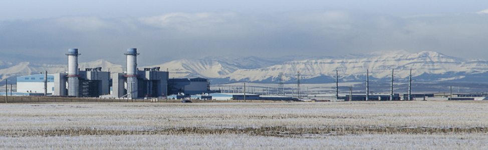

Shepard Energy Centre
Owned by Enmax and Capital Power
860-MW, gas-fired, 2 × 1 combined cycle powered by M501G1 gas turbines and located in Calgary, Alta, Canada

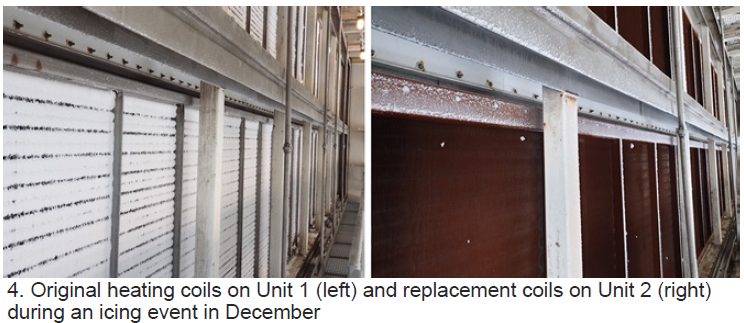

Early in the plant’s operation, staff observed that during low ambient temperatures and high humidity conditions, ice would form on the leading edge of the finned glycol heating coils. The gas-turbine control system limited the compressor bleed air system to operation at part load, thereby preventing the system from assisting with icing issues at base load. Even at part load, the nozzle distribution and resulting flow pattern were only able to prevent ice from forming in localized areas downstream of each nozzle.
To prevent the ice from choking air flow to the gas turbine (Fig 2), the plant operations team scraped the face of the glycol heating coils. This had to be done continuously until the ambient conditions changed. Such events were experienced on a weekly basis over the course of the winter, with a typical event lasting between two and eight hours. In severe conditions, scraping was unable to mitigate the ice formation and the gas turbines would be derated.

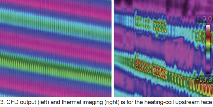

Solution. To further understand the issue and begin working toward a resolution, the plant commissioned a study to assess design documentation, review historical operating data, conduct a site survey, collect field data, and perform CFD modeling (Fig 3). It found the root cause of the glycol coil icing to be the materials of construction. The original coils were made of stainless steel having a poor thermal conductivity. CFD modeling showed that the temperature of the leading edges of the fins were expected to increase by only about 4 deg F above that of the ambient air. Issue identified, multiple options were proposed for permanent resolution.

In parallel, the plant team prepared for the complex task of swapping the heating coils through development of a detailed installation plan. This plan was executed during a scheduled gas-turbine outage, which included engineered scaffolding, mobile crane, jack-and-roll system, and over 2000 man-hours. All 12 coils (six left-hand and six right-hand) were safely replaced on schedule within a six-day window.
Results. The performance of the new coils has been validated during multiple icing events (Fig 4). The project has a forecasted payback period of less than five years. With the observed success, the plant is currently proceeding with plans to complete the heating coil replacement on its second gas turbine.
