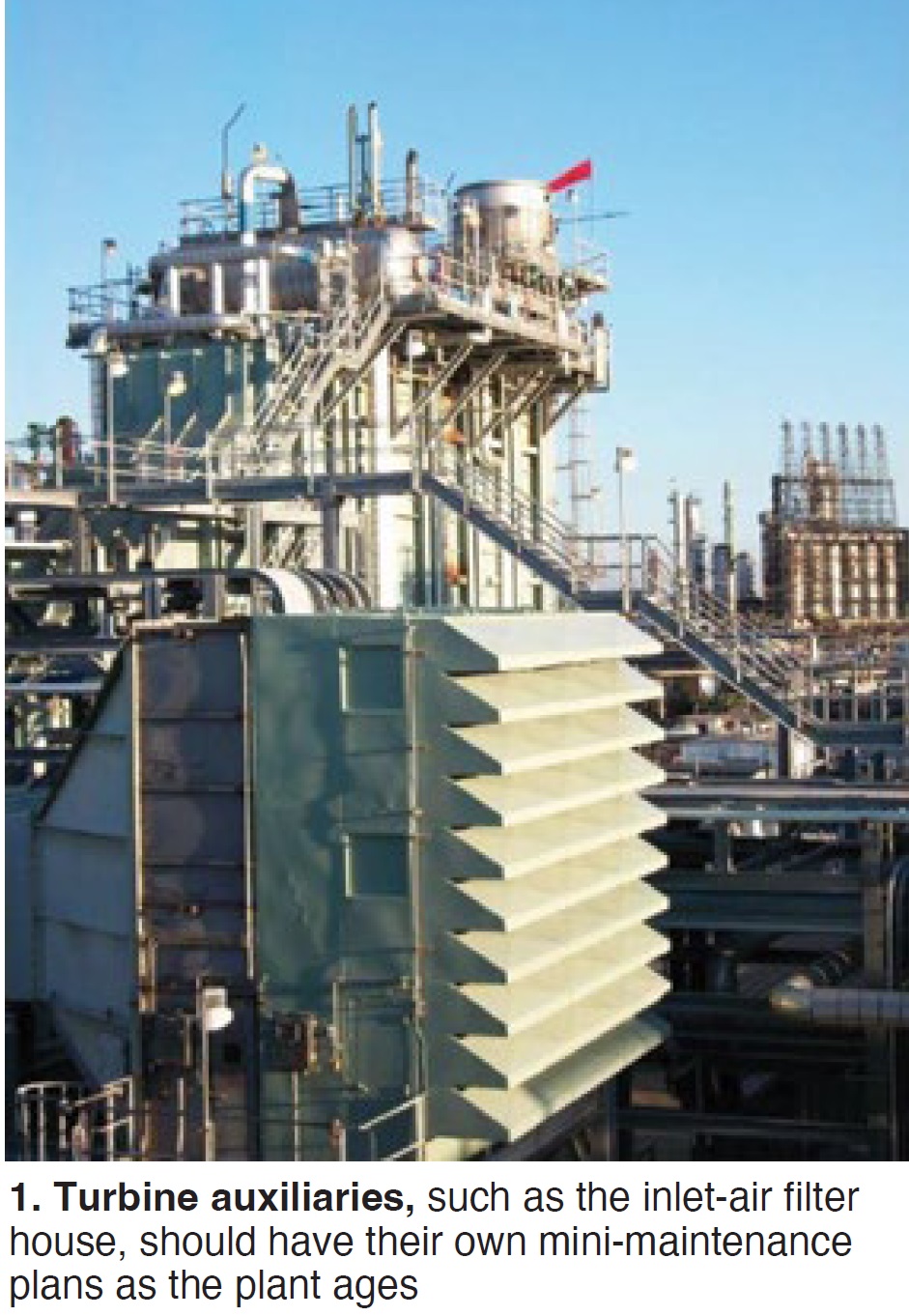

Maintenance, inspection, and inventory protocols have to adapt as machines enter the “ageless” realm. That’s as true for auxiliaries as it is for the gas turbine itself. One discussion leader said that there must be an inspection plan for every outage for the inlet air filtration housing (Fig 1). Why?
One small leak, such as during a super heavy rainstorm, and all the untreated water gets sucked into the HEPA filters, the pressure drop begins to rise “within hours,” and salts become entrained in the compressor flow.

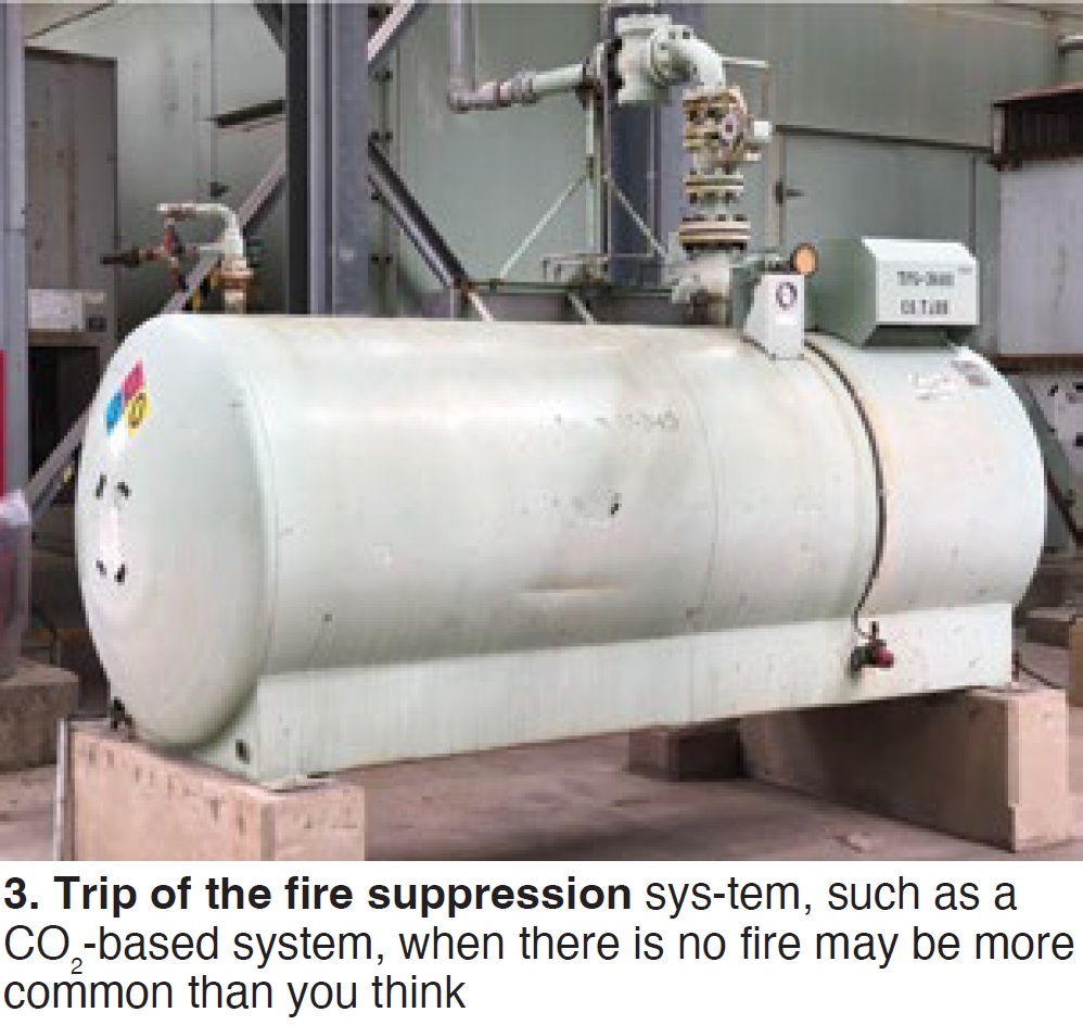

A big caution with CO₂ fire suppression, still pretty common with these machines, was not to get complacent. Turbine compartment entry at these sites was described as “one of the really scary things in the plant.” Keep the doors open and have a second person outside.
Older CO₂ systems may not have some of the safety features of new plants, such as lockable ball valves with installed safety pins blocking the discharge piping valves tied to the control system so there’s no way to trigger a CO₂ release which will immediately kill someone in the compartment. Be especially vigilant during unplanned maintenance activities, when the CO₂ system may not be part of LOTO, says one participant.
Hazardous gas detectors for the turbine compartment and fuel enclosures are included in DLN upgrades. One user noted that, in a Mark VI, the detectors go into a failed state after 360 days as a way to force the site to calibrate the detectors. Normally, these detectors should be calibrated at least every half a year.
About five attendees out of 60 or so noted that they have experienced a trip of the fire suppression system with no fire (Fig 3). Others noted that the wires to heat detectors break down from age or fail from vibration. All this is evidence that fire suppression systems require regular attention. Even the latest water mist systems, standard on new 6B units, are “a pain in the butt.” High-pressure air cylinders always go empty. Lots of fittings have little leaks, which empties the bottles, and then you have to hydrotest them before refilling.

Inlet air house:
  • If piping is on the outside, consider upgrading from PVC to stainless steel. One user experienced leaks in PVC piping almost immediately.
  • Conical-type filter elements will sag as they get dirty, which can open a gap between the filter media and the filter sheet, allowing air to pass through.
  • Change pre-filters every six to eight months, coalescers every four to eight months, or as needed.
  • Fog can be a huge factor in HEPA filter performance. Have filters tested for conditions specific to your location.
  • Housings may need to be recoated every outage.
  • Inlet foggers (for output boosts) may eke out a few extra megawatts but over years of service, allow dirt to pass into the compressor.
  • Silencer baffles made of galvanized carbon steel can rust and allow zinc to carry through the unit, clogging up the first-stage nozzle cooling passages.
  • Check water-wash spray nozzles and test them every time the unit is down. Gaskets on the demin water inlet piping can become brittle and fail.
  • Make sure you are consistent in how you measure inlet-guide-vane angles; get inside and use the right tools to measure.

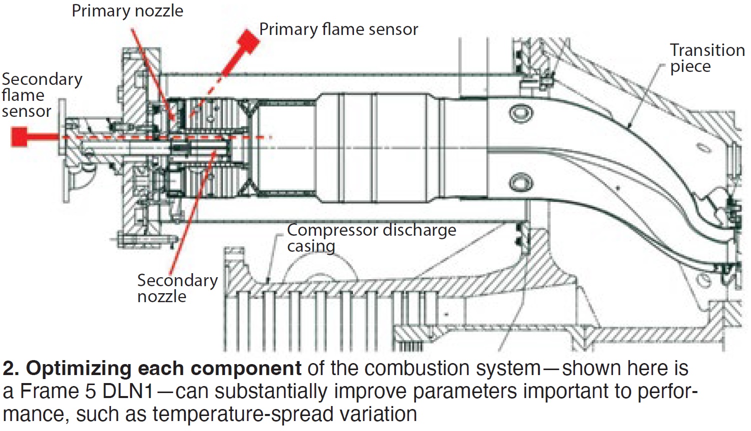

  • Crossfire tubes are burning out, especially on Frame 5s. This may be associated with coking, leading
  • an irregular flame pattern after dual-fuel testing. The 9/10 location is especially susceptible. Consider
  • the tubes a “consumable” and keep plenty of spares handy.
  • Leak- and flow-test fuel nozzles. They can start leaking after you stake them. Fuel nozzles also should be considered consumables. Make sure the mesh isn’t left in.
  • Check that liner repairs are correct: The floating collar can be out of position and damaged easily when you put the cap on.
  • Igniter cables can degrade after many years of service, and burn out.
  • Flame detector (non-fiberoptic) cooling tubing can leak; plan to replace every HGP major.
  • Flow-test combustion liners: The louvers inside can get damaged over time.
  • Pressure-test standard combustion cans and piping during outages. Check for leaks around the flange using tape that changes color when exposed to H₂.

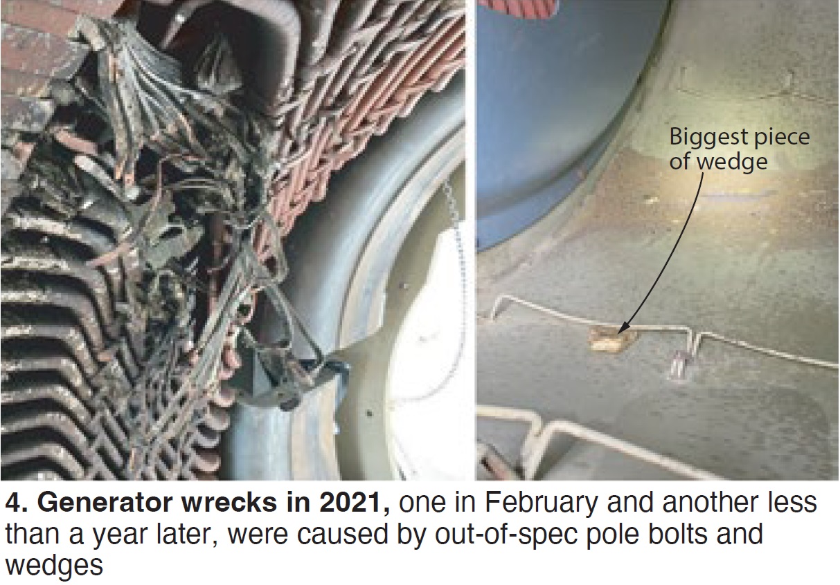

Finally, some gruesome photos of an “unfortunate event” are included in the slides used by the 6B group leaders in their Thursday session on generators. The generator in Fig 4 was wrecked in February 2021 and, after repairs and a stator rewind, wrecked again in December 2021. A failed wedge bolt was responsible for the first one, a failed pole bolt for the second. NDE examination revealed that some of these bolts did not meet specifications. Moral: Know your supply chain and all aspects of the manufacturing process, including base stock, forging, heat treating, painting, and cleaning.

Back to Basics: Generator Testing, Jamie Clark, AGT Services. A pictorial journey into various findings from comprehensive generator inspections, with close-ups of specific damage—such as insulation wear from loose bar ties, heavy greasing on connection-ring blocking, connection-ring tie wearing into insulation, endwinding broken ties, failed conductor, damaged laminations, overheated iron, and many more, along with repairs, fixes, and information on testing.

Combustion System Optimization, Jim Neurohr, Sulzer. Each component of the combustion system can be optimized and redesigned to create a new standard for performance and extended life, states the presenter, leading to lower fuel costs and more consistent fuel use.
