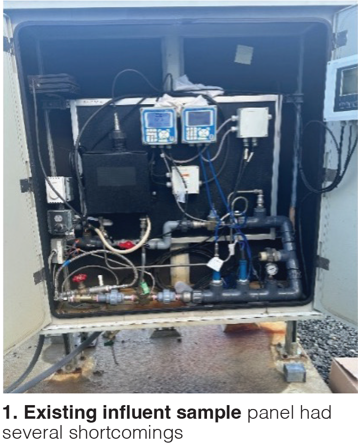

Solution. While evaluating options for real-time TSS monitoring, personnel realized the instrumentation setup for the existing wastewater sampling panel presented multiple maintenance challenges. Example: It relied on four instruments to measure specific conductivity, pH, ORP, and turbidity (Fig 1). The four probes were on a common sample line without individual isolations; thus, all four had to be taken out of service to maintain one of the elements. Plus, the panel had multiple transmitters of different models, requiring different sets of spare parts.

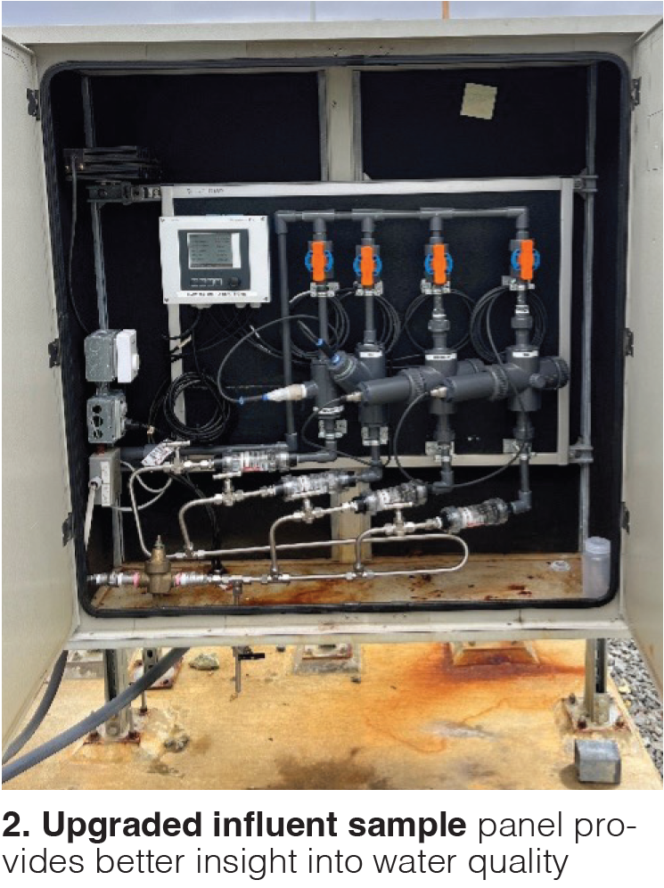

After planning and review, the site was able to install the new influent water sampling system (Fig 2) which addresses the maintenance challenges of the old system. The new panel is configured for all the instruments to run off a common transmitter, reducing the amount of spare inventory required. Plus, it allows isolation of one instrument at a time for maintenance.
An online TSS probe was added to the effluent water sample panel, allowing staff to compare TSS in the incoming water to that in the water discharged.
Result. The online TSS and sample-panel upgrade give the plant better insight into the quality of the reclaimed water—both incoming and discharged. Having the sample values displayed on the DCS allows the operations team to react quickly to changes in incoming water quality to protect equipment that relies on this water for cooling.
Additionally, it is now possible to monitor and evaluate TSS trends in the incoming and outgoing water to determine cleaning frequencies for the cooling-tower basin and wastewater sumps.

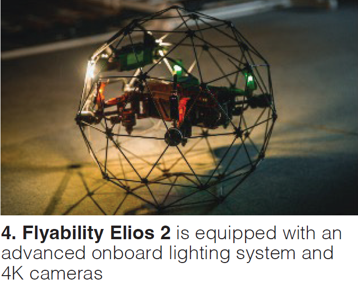

Solution. To overcome these challenges, St. Charles invested in a DJI Air 3 camera drone (Fig 3) for external inspections and leased a Flyability Elios 2 drone (Fig 4) for internal checks of HRSGs and stacks. This strategic combination of drone technologies revolutionized the plant’s inspection processes, enabling it to avoid the limitations previously encountered. Important to success was the site’s ability to leverage the operation manager’s remote pilot’s license issued by the Federal Aviation Administration.
The DJI Air 3 enables the capture of high-resolution photos and videos from vantage points previously inaccessible, providing unparalleled visibility of the plant’s exterior. Meanwhile, the Flyability Elios 2, equipped with advanced onboard lighting and 4K cameras, permits internal inspections of HRSGs and stacks with precision and thoroughness.
Results. Beyond the initial intended applications of conducting perimeter and HRSG internal inspections, the drones have unveiled a multitude of additional use cases. St. Charles has leveraged these versatile tools to capture timelapse footage of newly installed capital projects, assess building roofs and gutters before and after severe weather events, conduct winter insulation audits, perform stack inspections, and examine silencers for maintenance needs.
Moreover, the HRSG internal inspections yielded significant improvements in workflow efficiency. As a direct result of insights gained from the inspection process, modifications were made to the work scope, optimizing scaffolding placement. This adjustment reduced scaffolding erection time by eight hours, demonstrating one of the tangible benefits derived from the integration of drone technology into plant operations.
Furthermore, the use of aerial views on gutter inspections eliminated the necessity for operators to climb ladders in areas inaccessible by manlifts. Additionally, staff was able to pinpoint specific locations for clearance via manlift, improving safety and reducing total job duration by 75%.
