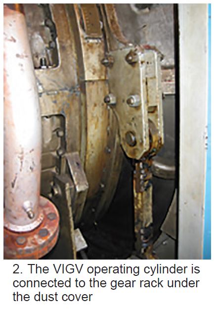

Proper operation of compressor variable inlet guide vanes (VIGV) is crucial for those gas turbines that have the “variable” design. Hundreds of components comprise a VIGV set and all must function properly and in unison. The operating cylinder must stroke; the rack must rotate; the vanes must all turn together to set the proper angle in the compressor inlet air.

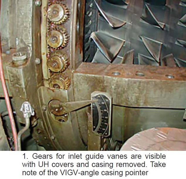

The VIGV set must rotate freely from the so-called “closed” to “open” position and back, depending on the turbine starting and operating design. End stops allow vane rotation through an arc of approximately 45 degrees. Free-moving vanes are vital to the proper startup, operation, and shutdown of the unit (Figs 1 and 2).

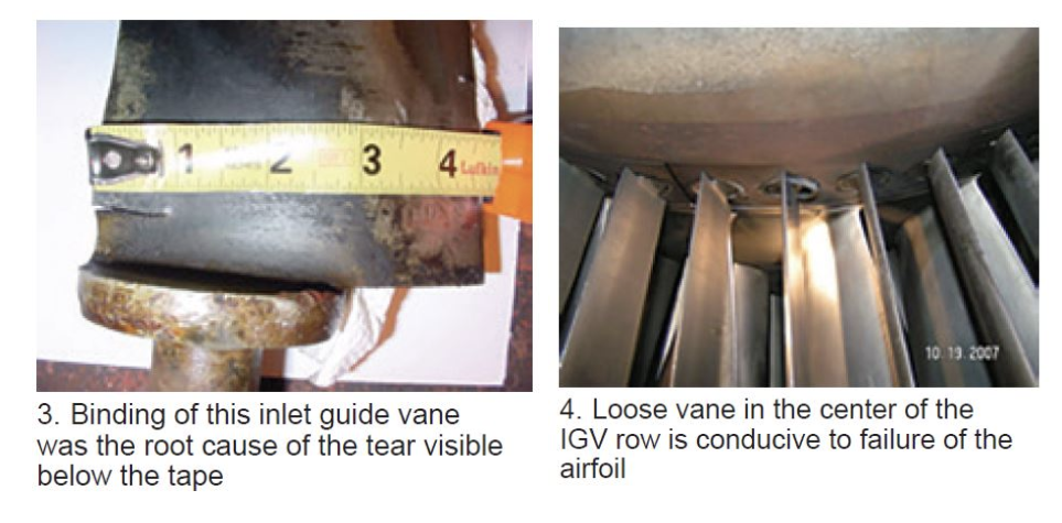

Fig 3 illustrates what can happen if a vane gear or bushing binds. The tear in this vane is about three-quarters of an inch in length. If the vane fails and eventually liberates, it could be sucked downstream and destroy compressor rotor and stator blades. A loose vane bushing also can cause a vane to bind, break off, and liberate (Fig 4).

      1. Measure the end-stop positions of the VIGV (open and closed) with the pointer on the IGV ring and scale on the lower half of the compressor forward casing (refer back to Fig 1).
