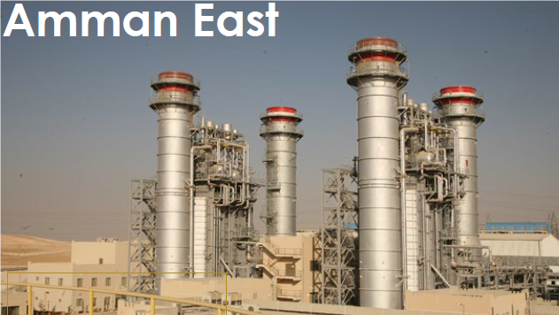

The Amman East Power Plant, owned by AES Jordan PSC, is a 420-MW, dual-fuel, 2 × 1 combined cycle powered by V94.2 gas turbines, located in Al Manakher, Jordan.
