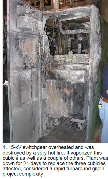

Overheating of generator main breakers was a consistent and major concern. Fire-hazard and personnel safety concerns always are paramount to any plant owner (Fig 1); plus, the potential for a plant trip and expensive forced outage can completely negate the value of a peaking unit. One plant installed thermal monitoring instrumentation as an advanced warning system, the other had multi-ton air conditioners blowing on its breakers to keep them cool.

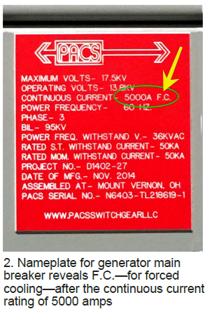

The long answer has to do with commercial considerations. Fig 2 shows that the equipment is rated for 5000 amps (continuous), but there’s an “F.C.” that follows that information—for forced-cooled. In all probability, this was the most cost-effective offering the OEM could incorporate into the total plant package “at the time.” Whether the components and designs pushed their limits is an open and ongoing debate.
Undoubtedly, Hack said, the design did not provide the sort of belt-and-suspenders safety margins that gets a plant 30 to 40 years of highly reliable, maintenance-light service. No one would have wanted an entire plant to depend on the operation of a few small fans and an auxiliary a/c system to keep breakers from overeating if it could have been avoided.
Hack dug deeper with a back-of-the-envelope calculation. He measured the lower stem of the vacuum interrupter at about 1 in. diam, meaning the conductor cross section was about 3.2 in.². A conservative rule-of-thumb suggests a maximum current flow of 1000-1200 amps/in.² for this breaker, which means it’s about 1200 amps less than the 5000-amp nameplate without forced cooling.
As Hack pointed out, “at 5000 amps you’re running a toaster in the middle of your circuit breaker. If you wick away the heat fast enough, you can keep things within limits. But the better solution is to simply use a properly rated, self-cooled 5000-amp breaker if at all possible.”
Hack’s conclusion: A better vacuum interrupter and properly paired mechanism design is needed for this breaker to be specified for 5000-amp service. As is, he believes it should not have been used above about 3600 amps, self-cooled.
