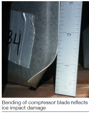

R1 compressor ice damage.
A Canadian user reported on a compressor ice damage investigation that was of interest to virtually all attendees (photo). Keep in mind, ice can form in a gas turbine compressor at an ambient temperature above freezing. The speaker explained this with several slides on the physics of ice formation at the beginning of his presentation. He also discussed the various types of ice and how they differ. Specifically, precipitate icing— such as hail, ice crystals, snow, freezing rain—and condensate icing—such as rime, glaze (clear), and frost/hoarfrost.
If you’re shaky on ice science, be sure to access this presentation on the 7EA Users Group website. It’s easy to understand and you can become an “expert” of sorts in short order.
The user’s root cause analysis focused on the following potential causes of ice damage:
    • Plant staff did not verify the wash water system was positively isolated and drained after each compressor cleaning. The water wash procedure was updated to ensure positive drainage of the wash-water manifold.
    • Inspections for leaks in the inlet ductwork and filter house were conducted, but no signs of water ingress were found.
    • The anti-icing (AI) system did not prevent ice from depositing and growing on air-intake surfaces. The details in the slides specific to the GE system are recommended viewing for anyone with a similar system and issues, and anyone planning on protecting his or her plant’s gas turbines in this manner.
The AI portion of the presentation began with a description of the inputs to the control system (inlet temperature and humidity) used by GE de-icing logic to control the inlet bleed heat (IBH) charged with preventing ice formation. Problems identified included the following:
    • Thermocouple noise, which was an easy fix by enabling a low-pass filter in the software (this is defaulted in normal control when the system is set up).
    • Poor IBH valve control because of the installed position feedback on the positioner. An upgraded valve positioner solved this problem.
    • Dew-point sensors were supplied by the OEM with the wrong range software. The instrument manufacturer corrected this by increasing the dwell time through the auto-purge sequence of the humidity sensor.
During the ensuing discussion it became apparent that the de-icing control provided by GE did not shut off until the ambient temperature rose above the set point—about 40F. The ambient temperature falling below the ice-formation temperature (too cold to carry moisture that would form ice) did not shut off the IBH (running at about 10%), regardless of how much colder it got. This results in a significant reduction in efficiency and output when operating at cold temperatures outside of the ice-formation physics.
Best practice: A user commented during the discussion that he and his colleagues had found a significant water entry point in the inlet ductwork. The bolting supplied during unit installation for clamping flange gaskets on the inlet “key” slot was bottoming out and not properly sealing the joint when the flange bolts were torqued. This permitted water entry into the inlet duct which could cause icing at low ambient temperatures.
