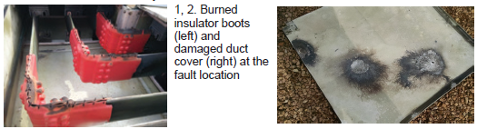

Two electrical faults occurred on a 13.8-kV bus within five years at Minnesota Municipal Power Agency’s Minnesota River Station, operated by NAES Corp. In both incidents, the solid copper bus and ductwork sustained extensive damage, resulting in lengthy forced outages. Figs 1 and 2 show the burned red insulator boots and damaged metal duct covers at the fault location.
During the first incident, the plant team, directed by PM Bob Burchfield, coordinated with the OEM and determined that the section of bus where the fault occurred had insufficient heating. Two new heaters were installed and inspections were scheduled more frequently.
Five years later, a fault at a different location required a more extensive investigation and more robust defense. Both events had occurred during conditions of extreme humidity with heavy rainfall and dew points above 73F.
A third-party engineering firm determined that the bus was designed for relative humidity of 95%. However, relative-humidity levels routinely exceed 95% during the spring and summer months in the region. Ductwork is vented to atmosphere through small screened holes, exposing the bus to ambient weather conditions.
While making repairs after the second incident, staff noticed that the OEM had modified the replacement parts. The red insulating boots now had the tie-wraps at the sides rather than on top. Previously, they had allowed moisture accumulating on the upper cover to drip into the seams and onto exposed copper bus. The OEM had also modified the metal duct covers to create more overlap, particularly on the corners.

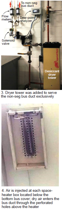

The following three-pronged approach was taken to prevent water from entering via the supplied-air system:
    • The team recognized that any malfunction of a regenerating dryer tower could allow water to enter the instrument air piping from the air compressors. Technicians didn’t completely trust the installed plant dryer tower, so they proposed adding a tap to the top of the instrument-air receiver tank plus another dryer tower dedicated solely to the non-seg bus duct (Fig 3).
    • Staff also procured and installed a dedicated dew-point analyzer and programmed it to shut off the air-supply solenoid at a predetermined set point. The normal dew-point temperature downstream of two dryer towers is very low, so a conservative shutoff set point of 0F was selected. Part of the logic in being this conservative was that the dew point remains relatively constant in the new system, so a change of any appreciable amount could indicate a problem.
    • Air is injected at each space heater box located below the bottom bus cover; dry air enters the bus duct through perforated holes above the heater. If water reaches this box from the air supply, it has a last chance of removal through the bottom screened hole (Fig 4).
The sheer size of this particular bus factored into the solution. The duct measures approximately 200 ft long and consists of three different sections. It is heated by 25 space heaters powered by two separate 120-V circuits; each heater draws slightly more than 1 amp.
The team procured and installed a current monitoring device. If any heater open-circuits, the current draw will drop by 1 amp. If an entire heater circuit trips, the new panel will display a loss of current. An alarm was not provided because a thermostat periodically will shut off heaters at 95F and this would cause nuisance alarms.
