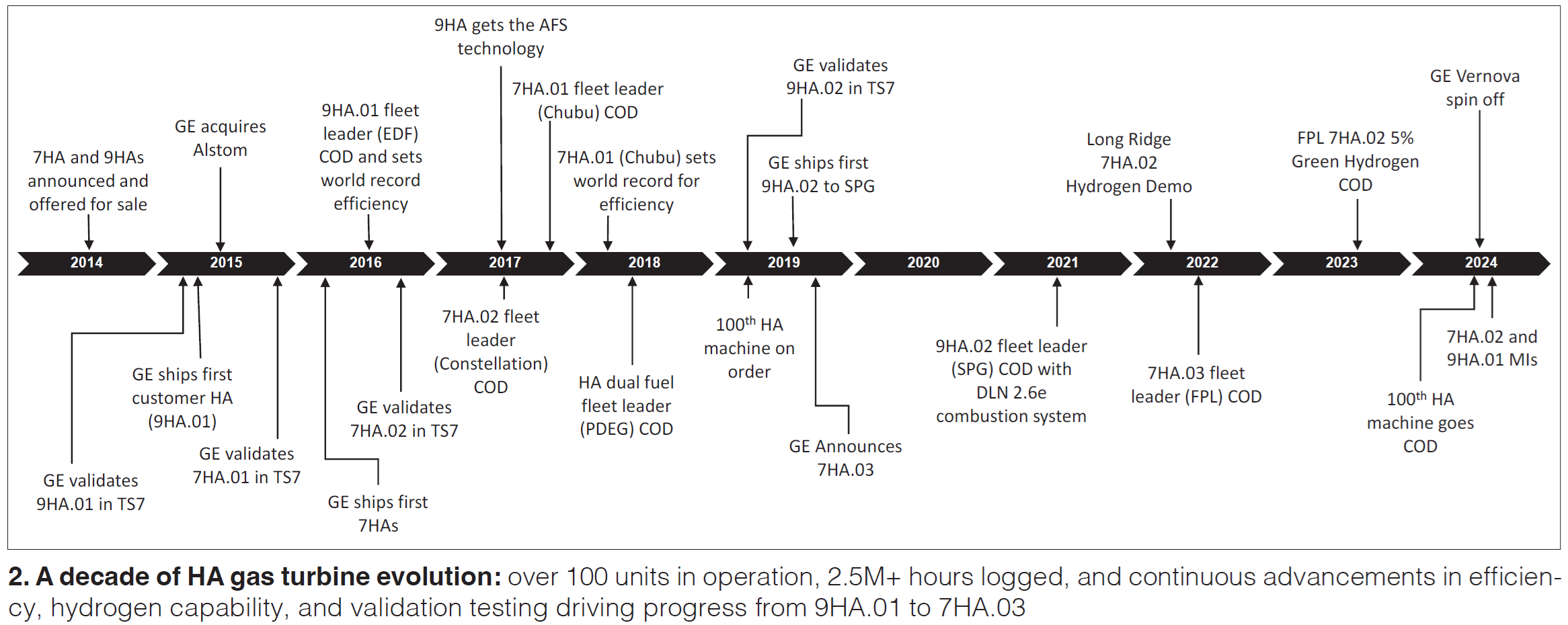

HA evolution
A late-1970s hit song by Talking Heads repeatedly asks the question, “how did I get here?” In a context-setting slide deck, one user representative and GE specialists reconstruct the evolution of the HA fleet from the 7FA.05 compressor, said to be the foundation of the HA design, to the latest models 9HA.02 and 7HA.03. Most of the machines operating or on order are of the 7HA.02 variety, but each of the units is related to the previous model.
For example, the newest 7HA.03 machine has more in common with the 9HA.02 version of the HAs than the 7HA.02, meaning the international user community has more to learn from each other than with the 7F and 9F users. One critical table in the slide deck compares the relevant design/performance data from the 7FA.04 and 9FA.03 through the 7HA.03 and 9HA.02 (Fig 1).
One fascinating tidbit from these slides is that 100 HA units were on order only four years after the first 9HA was shipped, and less than two years after the fleet leader 7HA unit began operating (Fig 2). Clearly, owner/operators were not taking a “wait and see” attitude before ordering. At the time of the conference, the HA product line had amassed 2.5-million operating hours.
One important distinction made here is between the 7HA.02 (FL16) and the 7HA.02 (FL18), the latter having a double-wall compressor, provisions for stage 4 blade cooling, higher firing temperature, and tighter HGP clearances, among other differences.

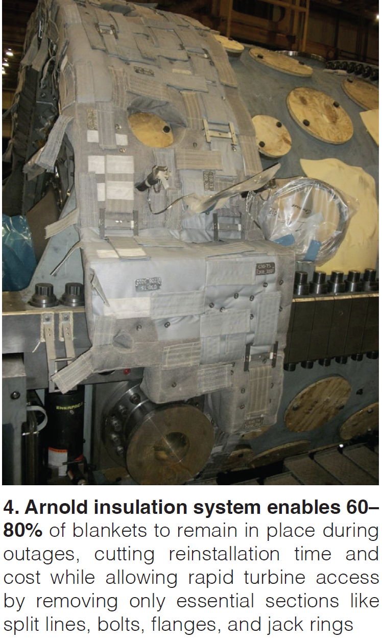

Complete cycle solutions for all GE H-class plants
Pierre Ansmann and Norman Gagnon – Arnold Group
Slides focus on the design and benefits of state-of-the-art insulation and warming systems for gas and steam turbines and, with EPRI funding, field testing results from latest warming and insulation system designs for HRSGs. D11 steam turbine case study reveals a start-time reduction from 266 to 149 minutes and 25% lower high-pressure (HP) rotor low cycle fatigue life consumption, along with attendant improvements in emissions and fuel consumption. A 250-MW unit will require a max of ~200 kW parasitic power and ~50 kW to maintain temperatures at shutdown. Install times are ~30 days.
Results from testing HP evaporator downcomer heating blankets at Duke Energy’s Buck facility Unit 12 showed (1) that HP drum pressure could be maintained at 20 psig for several hours, (2) lower tube temperature differentials, and (3) no large quenches or shocks during startup compared to the unheated Unit 11. There were extenuating circumstances typical of a field test, such as issues with instrumentation and components not built to commercial specs. Warming could be an alternative to steam sparging for reducing stress on pressure parts, but a large, dedicated power source would be required. Total install time is estimated to be 3-5 days with a 300-kW maximum power need, and ~100 kW to maintain temperatures at shutdown.
Accompanying photos and 3-D renderings show all aspects of insulation and warming system design including insulation thickness, support structures, joints and attachments, blanket shapes, blanket materials, and thermocouples. Commercial installations would require use of Arnold field services for removal, inspection, and re-installing insulation and heating elements to maintain warranty. Note that many of the 9H and newer 7H units come equipped with such systems because of superior quality and maintenance benefits (Fig 4).

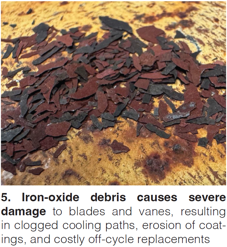

HVTS for casing corrosion mitigation
Eric Duvekot – Integrated Global Services
A proprietary superalloy applied using a high velocity thermal spray (HVTS) has shown to be effective in mitigating the flaking and spalling from unprotected low-chrome surfaces exposed to high-temperature oxidation in the compressor and combustion regions of the turbine. This debris damages fixed and rotating gas turbine (GT) components, plugs cooling passages, and erodes thermal barrier coatings (Fig 5). The material can be applied on-site in 6-10 days in a temporary, completely enclosed space. Since 2022, 11 GTs of various frames and outage configurations in baseload and peaking service have been clad, with subsequent borescope and IGS eddy current inspections showing zero coating degradation.
