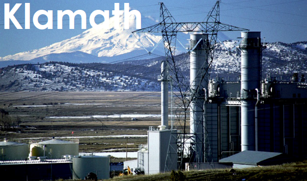

536-MW, gas-fired, 2 × 1 combined-cycle cogeneration plant powered by 501FD3/6 gas turbines, located in Klamath Falls, Ore
