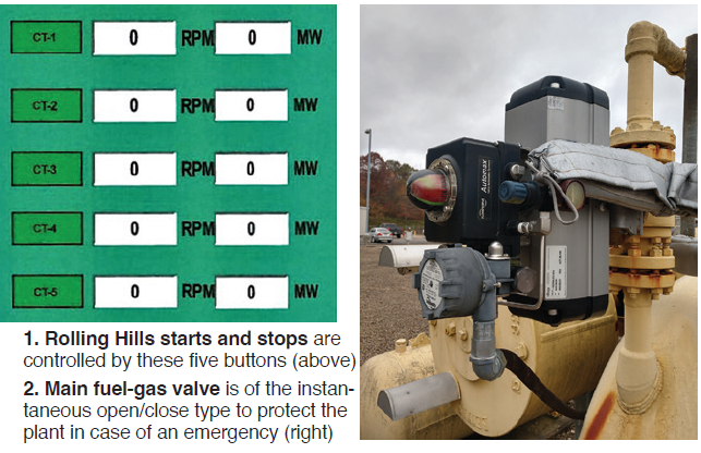

Solution. Logic changes were required to implement a simple remote start/stop routine. The plan: Create a single remote-start page that had only five buttons, one for each of the plant’s five gas turbines. With the main fuel-gas valve, fuel-gas heater, and demin-water pump already integrated into the DCS, focus of the plan was to electrically control the turning gear and the fuel-gas equalizing valve.
The turning-gear hand switch was located inside each units’ electrical package, where the PLC also was housed. A wire was run from an output card directly to the “auto” side of the hand switch, then mapped to the DCS for programming.
The last piece of the puzzle was how to ensure the pressure differential between the plant side and supply side of the fuel-gas system would not be so great as to impede safe operation. Bear in mind that the main fuel-gas valve is an instantaneous open/close valve to protect the plant in case of an emergency. Opening this valve when there is a high pressure differential would open relief valves throughout the plant, causing a high pressure drop.
Thus, the replacement for the hand valve had to be one that could be controlled by a 4-20-mA signal to regulate the equalization pressure. Plant employees installed the valve (Fig 2), ran the power and control wires, and mapped the valve back to the DCS for programming.
Lastly, the logic was created to automatically equalize Rolling Hills’ fuel-gas pressure, open the main fuel-gas valve, start the fuel-gas heater, reset any trips on the unit, place the turbine on turning gear, and then, after a set time, start the unit. Staff mapped the new logic to pictograms and placed it all on a special, designated remote-start page, reducing the start and stop sequences to a single-button permissive per unit (Fig 1).
Result. All employees were trained on the new start procedure. The simplified process helps prevent operators from missing any steps and has allowed them to start units remotely with ease. Success: Every technician has started units remotely and Rolling Hills has not missed a dispatch within the 5-min window.
Logic was reversed to make the unit stop sequence as easy as the start. By simply sending an “off” permissive using the same single remote-start button, the unit virtually runs the logic backwards and shuts down everything automatically—all while remaining smart enough to know when another unit is running and not to stop the fuel and water system. Plus, also placing itself back on turning gear for unit cooldown.

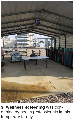

Solution. First step was to improve the plant’s safety orientation plan. Contractor orientation and visitor registration procedures were rewritten, paying close attention to detail to limit Covid exposure from outside sources.
Prior to being admitted onsite, contractors were emailed an information packet that included instructions on where to park and report to for a wellness screening conducted by contracted health professionals (Fig 3). Good health verified, contractors were directed to the plant warehouse, which was converted to a breakroom for safety orientation—complete with DVD player, procedures, and required paperwork.
Rolling Hills staff was on hand (at a safe distance) to answer any questions contractor personnel might have had during their self-guided orientation using strategically placed plant radios.
