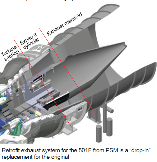

Background. The 501F exhaust system has two principal components: an exhaust cylinder, connected to the turbine case on its inlet side and to the exhaust manifold on its outlet side (drawing). The cylinder may be of single- or two-piece construction. PSM’s “drop-in” replacement is a horizontally split two-piece cylinder, the only option available for pre-501FD3 machines when they were purchased. This configuration typically is preferred by users because they can maintain their current maintenance practices in future outages.
Depending on component dimensions, a spacer piece may be required downstream of the exhaust manifold to fit up with the heat-recovery steam generator. An expansion joint is located at the round-to-square transition between the manifold or spacer and the HRSG. In the case of a simple-cycle unit, there would be no HRSG and the manifold or spacer would connect via an expansion joint to the transition piece directing exhaust gas to the stack.
