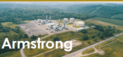

Armstrong Energy, a 625-MW, dual-fuel, simple-cycle peaking facility in Shelocta, Pa, is equipped with four 7FA.03 gas turbines. It is owned by LS Power and operated by IHI Power Services Corp. Brent Yatman is the plant manager.
