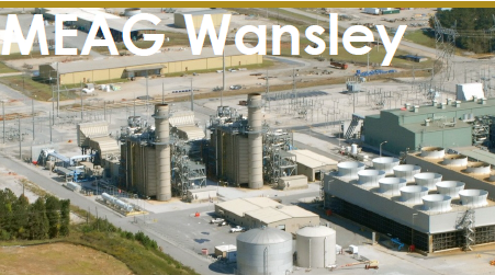

MEAG Wansley Unit 9, a 520-MW, 2 × 1 combined cycle in Franklin, Ga, is owned by the Municipal Electric Authority of Georgia and operated by NAES Corp. Plant manager is Timothy Williams.
