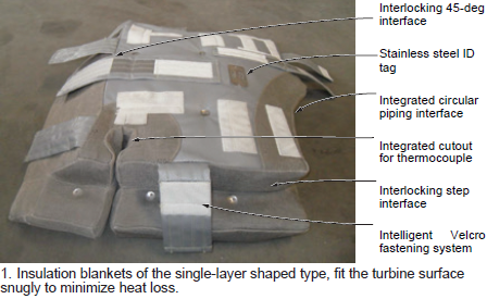

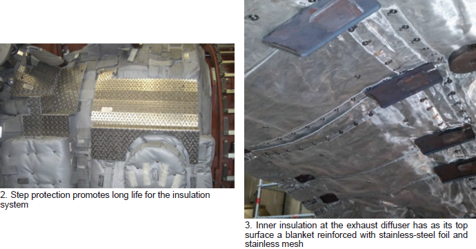

The ARNOLD team said its insulation avoids the stated problems because of interlocking high-performance blankets which conform perfectly to the turbine surface, high-quality materials and manufacturing, and long-term high-temperature resistance (Fig 1). The company guarantees reuse of its insulation system for 15 outages without a decrease in efficiency.
Highlights of the well-illustrated presentation (well over 100 high-quality photos showing details important to users) include blanket construction, design of the support structure, ease of access to inspection points, step protection for longer life (Fig 2), piping and flange insulation, insulation for inside the exhaust system (Fig 3), insulation system designs for the GT24, GT26, 11N, 13D, and 13E2, and steam-turbine warming systems (Fig 4) and associated controls.
Wrapping up, Arnold and Ansmann told the owner/operators they can expect a significant decrease in compartment temperatures by installing ARNOLD insulation—sometimes as much as a 50% reduction—and benefit from a commensurate reduction in fuel consumption and increase in power production. Plus, with fewer blankets to remove, repair, and replace, outage time and cost are reduced.

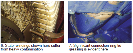

As for what to inspect on the stator, he listed the winding, endwinding support system, wedge system, gas-gap baffle studs, rubber baffles, bushing box, and stator core (for tightness, iron migration, damaged/overheated laminations, and vent duct blockage.
More than three-dozen photographs helped the users understand what to look for and how to evaluate what their level of concern should be. Example, he had a picture of endwinding contamination to show what it looked like and then a photo of heavy contamination (Fig 6) of greater concern. Other photos illustrated bottom-bar insulation damage, global greasing at end wedges, significant connection-ring tie greasing (Fig 7), iron oxide from key-bar rattle, etc.

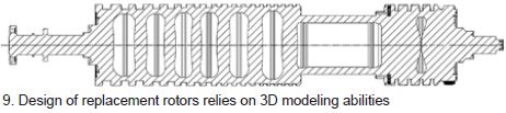

In the event indications are found, Doosan creates the models necessary to determine a repair plan capable of restoring the rotor to good health. Life-assessment simulations are run to estimate remaining life and assure repairs are not life-limiting.

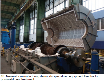

In cases where rotor replacement is necessary, Doosan’s LaPorte (Tex) facility has access to the global company’s heavy manufacturing shops for steam and gas turbines in Changwon, Korea, and to its Skoda works in the Czech Republic.
Reverse engineering and 3D modeling are among Doosan’s core competencies.
The presentation illustrated the company’s physical facilities for manufacturing replacement rotors—including forging, welding, machining, assembly, and balancing equipment (Fig 10).

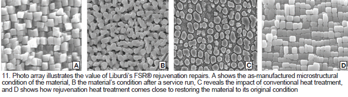

Liburdi’s component repair philosophy underpins its value proposition and success in maximizing the lives of HGP parts. It has these three components:
    • Listen to what the engine and the parts are saying.
    • Do not just repair, but rejuvenate (Fig 11).
    • Upgrade components to mitigate service damage.
Nagy went on to explain its engineering analysis (mechanical and metallurgical) capabilities, component-assessment process, and the repair technologies it employs—including alloy rejuvenation, powder metallurgy for metal replacement, automated welding, and high-performance coatings. His presentation is a worthwhile read for anyone wanting to understand more about HGP repairs; it offers important details yet is understandable for those without a background in metallurgy and gas-turbine repairs. Users can contact Conference Organizer Jeff Chapin for a copy.
