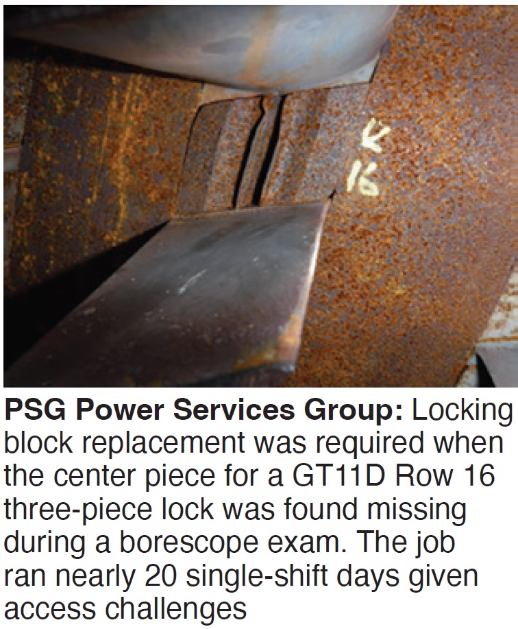

  • Locking-block replacement for a GT11D found missing the center portion of its block during a borescope inspection.

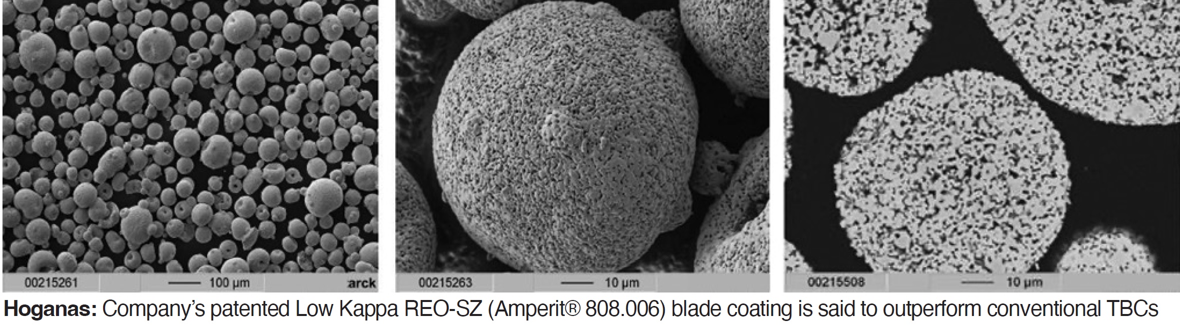

David Sanson’s presentation begins with a crash course on standard thermal barrier coatings (typically 7-8% yttria partially stabilized zirconia, used effectively for more than 50 years) and their morphologies and microstructures. He then reminded attendees that conventional TBCs may be challenged at today’s high firing temperatures, pointing to numerous recent patents for advanced coatings.
Sanson then discusses the benefits of his company’s low-kappa REO-SZ (Amperit® 808.006), a product users might want to investigate. Data presented include thermal conductivity, thermal-shock-test results, and SEM and phase analysis (EDS and XRD). Höganäs offers a wide range of powders that meet Alstom specs.
