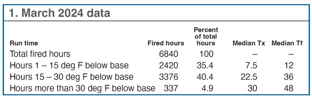

In June 2023, timers were installed in the plant’s Speedtronic™ Mark V control system to record the fired hours from 1.0 to 15 deg F below base reference, 15 to 30 deg F below base reference and more than 30 deg F below base reference. Results of data taken in March of 2024 are presented in Table 1.

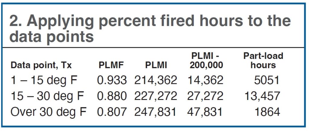

Next step: Calculate the part-load maintenance intervals (PLMI) using the actual median firing temperatures (right-hand column in Table 1). For the 1 – 15 deg F case (first line in Table 1) with a Tf of 12, Eq 3 reveals:
0.667 + [(1 – 0.667) × (100 – (12 ÷ 100))] = 0.667 + (0.333 × 0.88) = 0.667 + 0.266 = 0.933.
Thus, the PLMI  = 200,000 ÷ 0.933 = 214,362 fired hours.
For a Tf of 36 (second line in Table 1), the part-load maintenance factor (PLMF) is 0.880 and the PLMI, 227,272 hours.
For a Tf of 48 (third line in Table 1) the PLMF is 0.807 the PLMI, 247,831 hours.
Applying the percentage of fired hours to the three data points:
The original data collected in 2022 estimated a part-load rotor maintenance interval of 239,952 fired hours. The actual data collected in 2024, considered more accurate, produced an interval of 220,372 fired hours, or 18,580 hours less than estimated two years earlier.
