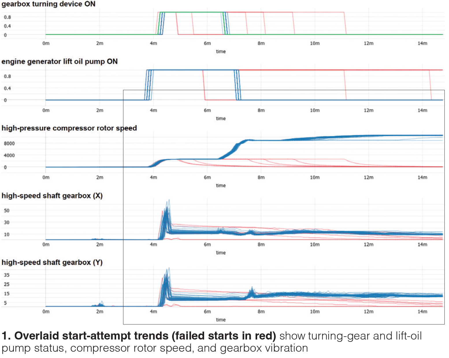

SWM also applied the same data-centric approach to intermittent false starts, described as shutdowns initiated by the turning gear at low speed, followed by successful subsequent cranks. By overlaying multiple signals across start attempts and distinguishing failed versus successful patterns, SWM identified a no-lift condition during false starts. A subsequent inspection found the jacking-oil pump degraded, enabling targeted corrective action rather than extended troubleshooting by substitution (Fig 1).
