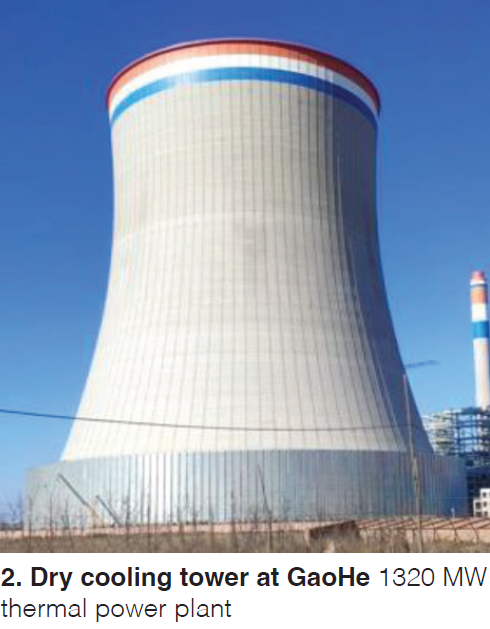

György Budik, MVM EMI, then showed the largest hyperbolic dry cooling tower in the world, a 220 m high tower serving two 660 MW units (Fig 2). Budik showed more conventional units in his global review, including hybrid wet/dry units.

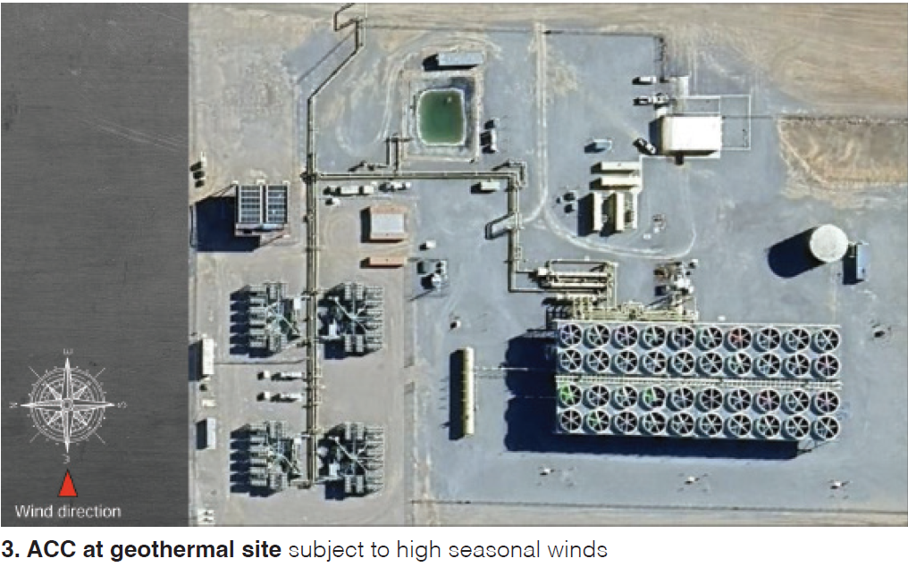

Jeff Ebert and Gary Mirsky, Galebreaker, then discussed Wind effects on an ACC at a geothermal power station . See Fig 3.

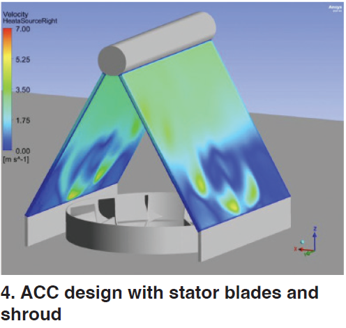

Andy Howell, co-chair, then offered a presentation submitted by Mohamadreza Vaghar, Mapna Development Company, Iran, on Fluid flow analysis in the air-cooled condenser system .
This covered investigations of air flow modifications over tube bundles to improve efficiency, and a technical evaluation of the absence of wind walls. The goal of the first is to improve air flow uniformity. The proposed solution is stator blades with and without a shroud. Use of the shroud (Fig 4) produced a more uniform flow profile and increased average velocity.

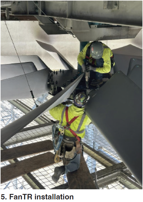

Bernardo Navarro, Fan Technology Resources (FanTR) and Jared Miller, Evapco Dry Cooling, discussed an Innovative fan blade with aerolastic design. The focus was a new cooling fan blade named X-flow, designed for “extremely high efficiency.” Other benefits of this unique aerodynamic design are lower operational costs, reduced vibration, and an interchangeable hub with all FanTR models (Fig 5).
The manufacturing process is one-shot vacuum infusion for increased durability. This monolithic construction eliminates adhesives or bonded parts. The final design result is less stress on gearboxes and structures, less influence by cross winds, reduced maintenance costs, and longer life.

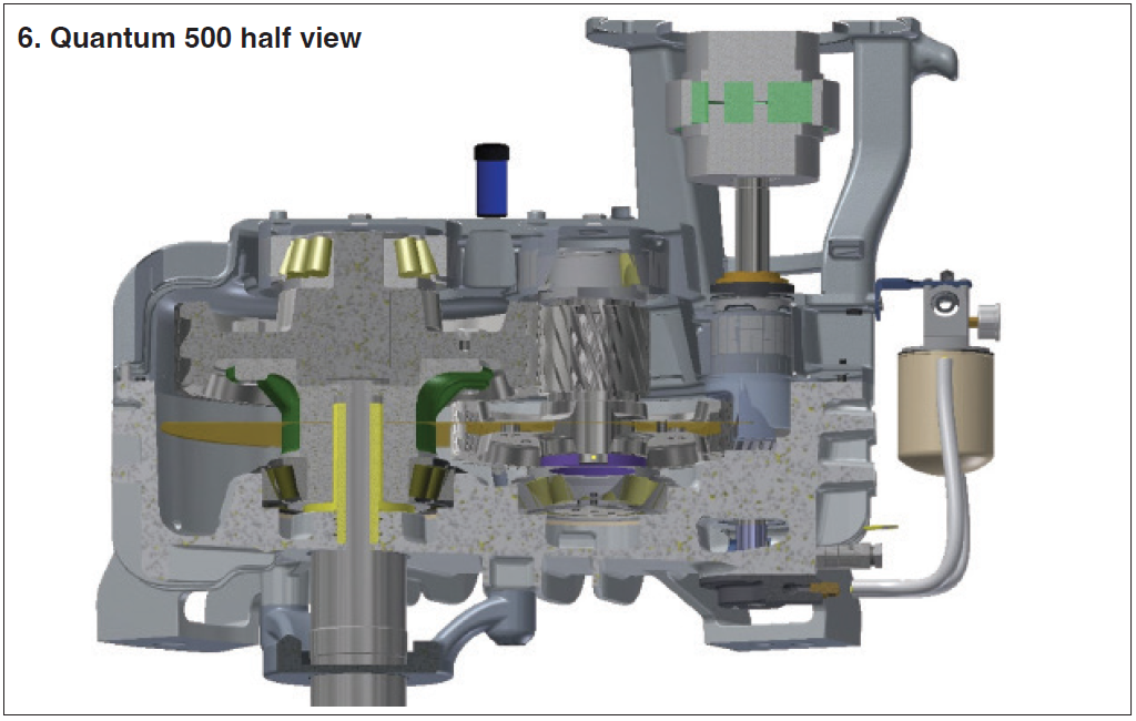

Patrick Saussus, Evapco, and Bob Neely, Amarillo Gear Company, addressed Common problems with gearboxes and offered details on solutions. The items discussed included oil leaks (output and input shaft), gear tooth wear and breakage, bearing failures, and oil pump malfunctions.
The Amarillo Quantum Q500 (Fig 6), designed specifically for ACC application, features no oil seals (no replacements), the output shaft bearings located in the oil sump (no grease or regreasing required), and no lip seals in the input shaft (for reduced maintenance).
They offered details on gearbox design and manufacturing, castings, gear design specifics, tapered roller bearings, lubrication benefits, and leak-free design (input and output). They then addressed retrofit options and benefits, including installation examples.

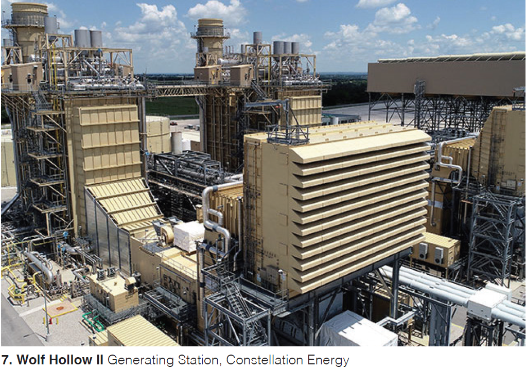

Wolf Hollow II : The conference concluded with an ACC tour at Constellation’s 1115 MW Wolf Hollow II Generating Station in Granbury, TX (Fig 7).
