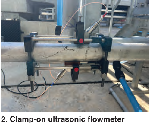

Solution. PROENERGY uses a non-invasive clamp-on ultrasonic flowmeter to measure natural-gas flow while the unit remains online, providing a faster, lower-cost recertification option (Fig. 2). The method can be completed in hours rather than days, avoids unit downtime, and minimizes cost. When paired with a Relative Accuracy Test Audit (RATA), it also requires no additional testing days.

Case study 1: Zero-downtime EPA compliance. PROENERGY helped a WattBridge facility maintain EPA compliance with zero downtime by completing two required tasks during a single mobilization. The site faced the same deadline for its annual CEMS RATA and the 20-calendar-quarter fuel flowmeter certification requirement for each unit. PROENERGY combined the RATA and fuel flowmeter certification work using an ultrasonic flowmeter to measure fuel flow, saving up to four days of combined downtime.
Case study 2: Out-of-compliance avoidance. For a third-party client, the PROENERGY Environmental Services team arrived onsite and completed the required certification the same day, preserving EPA compliance with zero downtime. The client had initially planned to purchase new flowmeters and swap them out ahead of the compliance deadline for two natural-gas-turbine fuel flowmeters. That plan became impractical because of supply-chain constraints and limited lab availability for certifying existing meters. The PROENERGY approach saved up to two days of downtime while avoiding delays tied to parts and lab access.

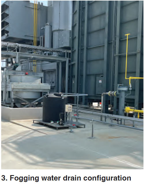

Solution. Vanessa Garcia, fleet engineer, led the development of a fogging-water reclamation system by leveraging plant personnel knowledge and using as much existing infrastructure as possible. With summer approaching and limited time for design, procurement, and installation, Garcia coordinated an effort that combined in-house engineering resources with a third-party vendor.
Within months, the team designed and installed a modified fogging system that reclaimed runoff and improved water use across the WattBridge peaking fleet. The system captured runoff water, pumped it to a temporary tank, and returned it to the raw-water storage tank for reuse. The drain-collection arrangement included pump skids, piping, and a tank (Fig 3).
Results. The team’s zero-tolerance approach to unauthorized process-water discharge, combined with a focus on reusing high water volumes, met environmental requirements and reduced water costs by approximately $2.2 million. Those savings were achieved even while using well-water assets to produce demineralized water.
