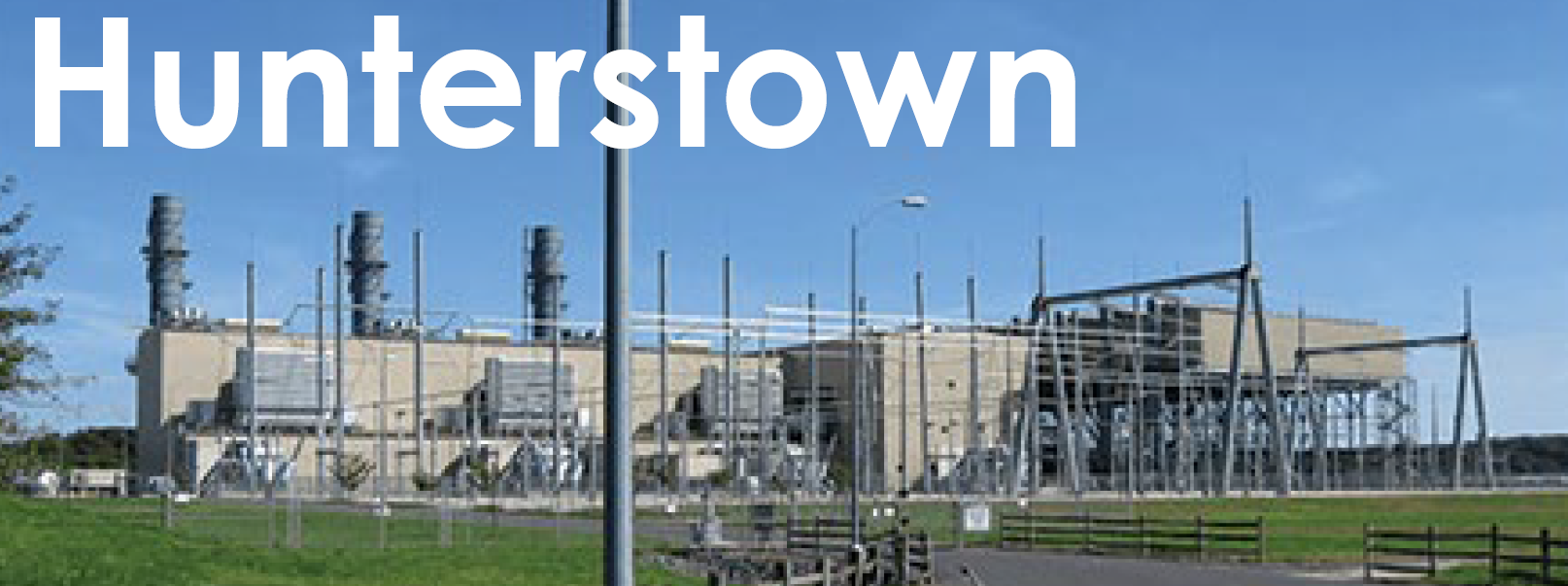

HUNTERSTOWN GENERATING STATION, managed by Competitive Power Ventures and operated by NAES Corp, ensures outage LOTO accuracy and completeness by mapping procedures on drawings. Plant Manager Thomas Hart said the challenge was to clearly identify the LOTO scope and to provide the means to present and communicate the safety plan to all outage employees, including outside contractors.
Hunterstown requires that all outage LOTOs be mapped out on electrical and mechanical drawings. Locations of work must be delineated in the drawing package and isolation points highlighted, demonstrating the relationship between workscope and LOTO boundary.
This proven process provides the means to easily demonstrate through a drawing review and walk-down of equipment that the site’s LOTO program is effective and the specific workscope to be performed by a contractor is compatible with the LOTO scope applied to the equipment and presented in the LOTO package (including drawings). This results in clarity for contractors and confidence in the site’s safety programs. Because of this there are fewer requests from contractors to make changes that would expand LOTO scope to increase the LOTO boundary.
Feedback from contractors has been positive. One example: GE said, “Hunterstown’s LOTO program is unmatched in providing clear understanding to the scope of the LOTO and how the work we will be performing is covered under the LOTO hung on the equipment in the field. With our GE procedures, we are required to walk-down every LOTO and Hunterstown’s program provides assurance that we can clearly see on paper in the marked-up drawings how what we see in the equipment walk-down provides protection for our workforce.”
