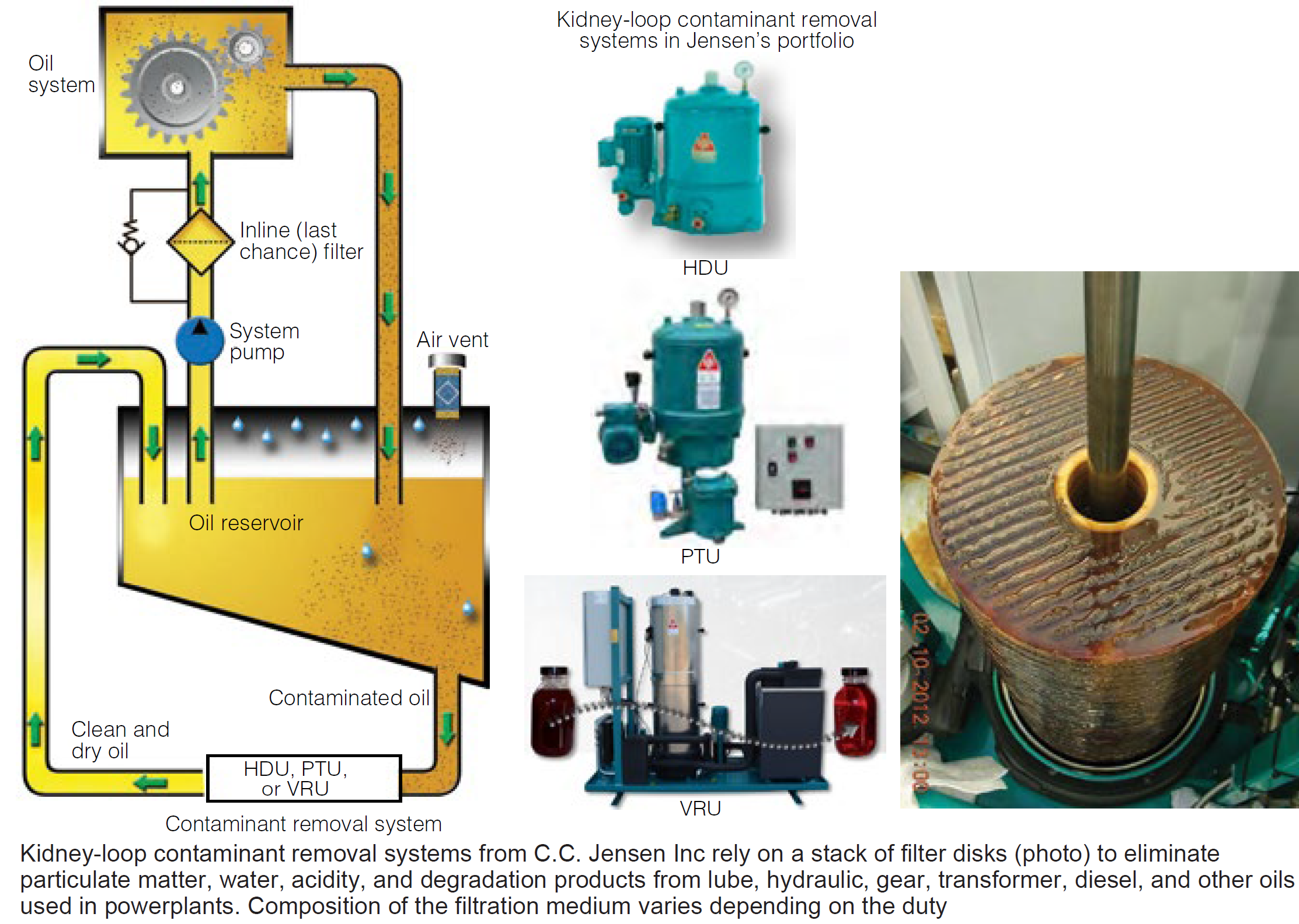

Converse, who has been at Wildcat Point since before commissioning, said the first oil conditioning systems installed were C.C. Jensen Inc’s off-line (a/k/a kidney loop) HDU fine-filter solution for the gas-turbine control-oil sumps (figure).

Why kidney loop. Kidney loop or offline filters benefit users because they are independent of the fluid system and always in service at an optimal flow rate—thereby avoiding pressure fluctuations and other disturbances that might otherwise negatively impact rotating equipment. Plus, they achieve very fine filtration. As the illustration shows, turbine fluids are withdrawn from the lowest point in the oil reservoir, removing sediment in the process.
All of the Jensen offline filters installed at Wildcat Point—HDU, PTU, and VRU—are arranged in this manner. Likewise, all are designed to (1) remove particles 3 microns absolute and larger, (2) absorb up to 1 gal of water per filter insert, and (3) remove insoluble varnish. This performance is achieved by a stack of two or more filter inserts, such as those shown in the photo, made primarily of compressed wood cellulose and cotton linters.

Applications. The HDU and its standard filter insert are designed for use in applications except where water ingress is expected. Special inserts are available for acidity reduction, dissolved-water removal, and soluble-varnish removal.
The PTU is used mostly with steam-turbine lube-oil systems (and diesel-oil filtration systems) because of its ability to remove large quantities of water from the turbine fluid and discharge it automatically.
Wegner says the PTU has advantages over dehydrators often used in ST control- and lube-oil systems for this application—including lower capital and operating costs, ability to remove particulates and varnish, and faster water removal. However, dehydrators may be beneficial in systems charged with fluids having poor demulsibility (don’t shed water easily). Centrifuges, a third alternative for water removal, are limited in their ability to work reliably over long periods and to reduce moisture levels to the 20 ppm often recommended today.
Jensen’s VRU typically serves on large gas and steam turbines where large amounts of soluble varnish must be removed from lube oil. A specially designed filter insert removes dissolved and suspended soft contaminants by polar attraction and alerts on varnish saturation by high pressure. The varnish-free oil produced cleans all system components it comes in contact with, ultimately reducing the level of varnish in the full charge of fluid to near zero.
Jensen recommends that its filtration systems run 24/7/365 and that the filter inserts be changed annually, when the pressure drop across the filter exceeds the recommended limit, or when oil analysis requires a change—whichever comes first.
