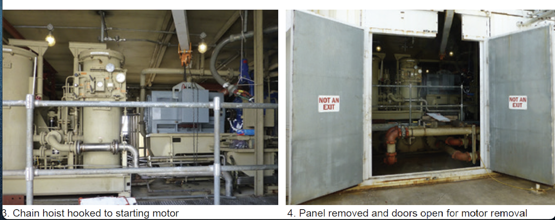

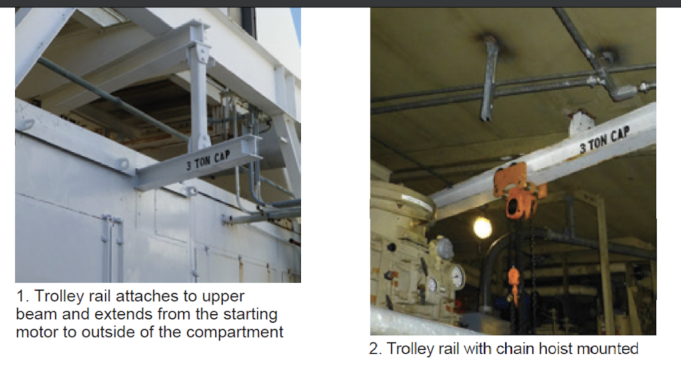

Starting-motor trolley rail increases outage efficiency, safety
Florida’s Mulberry Cogeneration, owned by Northern Star Generation Services and operated by CAMS, operates daily on a contractual peaking basis and provides service during peak daytime hours for the seven-month summer period, and during the morning and evening peaks for the five-month winter schedule. This equates to nearly 500 starts annually.
The demanding operational profile requires absolute dependability of the starting motor, located in the auxiliary compartment. Staff, led by Plant Manager Allen Czerkiewicz, found that having a spare motor and rotating it out every year for maintenance ensured high reliability. However, that was not an easy task. Access to the starting motor was blocked on one side, and limited on the other side, by the water-injection skid. Top access was prevented by inlet air ductwork.
To swap-out the motor, the auxiliary compartment roof had to be unbolted in two sections, lifted, and walked back. After fire detection and other conduit were removed, the side walls of the compartment were unbolted, and a crane lifted them out of the way.
The motor then was lifted by chain hoist and rolled out of the compartment on the installed trolley beam, which was mounted to the underside of the inlet-house frame. When outside the compartment, the motor was lowered to the ground and a crane moved it to an awaiting truck. The entire evolution took four to six people an entire day.
Team Mulberry looked at several possible solutions to make this job faster and safer, settling on the installation of a lower trolley rail that attaches to the existing trolley rail (Fig 1). The new rail extends down into the auxiliary compartment (Fig 2) and follows the existing beam out through the side of the compartment. The roof penetrations are sealed to retain CO2 fire system integrity.
The new configuration allows the motor to be lifted (Fig 3) without removing the roof, the side walls, or the conduit. Then it is rolled outside the compartment and lowered to the concrete pad. A forklift moves the motor to the warehouse. Only a small sealing panel must be unbolted to open the side wall doors for easy access (Fig 4).
First use of the modified system was as easy as had been foreseen and resulted in a huge man-hour saving. Plus, a safety improvement, by eliminating the need to handle large roof and wall sections by crane. The removal process for the motor now takes two men only two hours, saving cost and freeing-up plant personnel for other outage tasks.

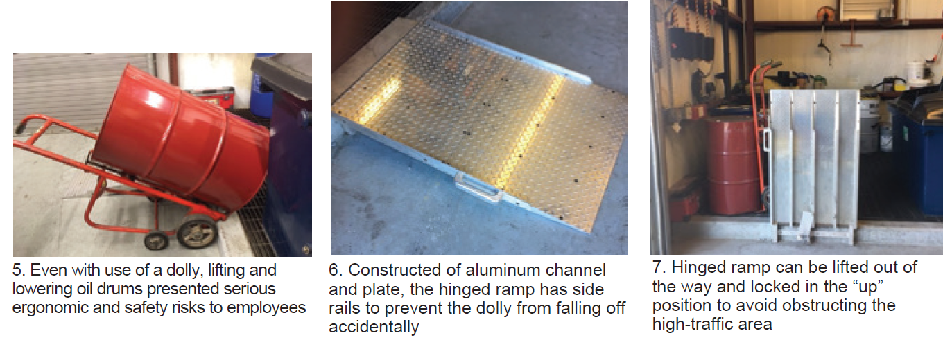

Improved oil-drum handling practice mitigates safety, health risks
Oil-drum receiving and distribution at Wolf Hills Energy, owned by MPR Genco and operated by NAES Corp, required lifting and transport of heavy drums, which presented an ergonomic risk, as well as a safety risk, to plant personnel. To move a drum into the storage/containment area, staff would place the drum dolly on the lip of the containment area, then lift it into place (Fig 5).
To remove drums from the area, they would roll the dolly off the grating and, if wheels were not perfectly aligned when the dolly left the edge, it would destabilize the drum, forcing the handler to twist in order to correct the weight imbalance, possibly incurring a strain or sprain.
After studying the situation, Plant Manager Michael Beverley and his team came up with a design for a hinged ramp, which was then fabricated. It allows offloading and loading of the drums into the storage area without ergonomic or safety risk (Fig 6).
It was constructed of aluminum channel and plate, making the ramp light enough to lift easily when not in use and avoid obstructing the high traffic area. The Wolf Hills team also provided side rails to prevent the dolly from rolling off the ramp (Fig 6) and designed a locking mechanism to hold up the ramp when not in use (Fig 7).
The team’s solution answered all of the plant’s needs:
    • It reduces the ergonomic and safety risks associated with transporting the heavy, unwieldy drums yet allows free flow of traffic when not in use.
    • It is strong enough to serve the purpose, yet light enough to be easily lifted; the locking mechanism prevents accidental lowering.

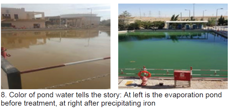

Reduce iron content of wastewater to allow unrestricted discharge
Iron in plant wastewater, attributed to HRSG tube leaks, exceeded permit limits at AES Jordan PSC’s Amman East Power Plant, a 420-MW 2 × 1 combined cycle. Unable to discharge water as is, the only viable solution appeared to be use of so-called authorized discharge tankers. But given the large volume of water, the cost of disposal would be prohibitive. Station personnel, led by Plant Manager Peter Kuijs, dug into the literature and found a technique for precipitating the iron to the bottom of the evaporation pond.
The precipitation reaction requires addition of trisodium phosphate and sodium hydroxide, plus lime to raise pond water pH to 8 to speed coagulation. The chemistry is relatively simple: Ferric ions combine with phosphate to form ferric phosphate which can be mucked from the pond.
Equipment required for the chemical reaction is standard and relatively inexpensive: dissolving tank, electrical agitator, chemical transfer pump, and associated piping and mixing nozzles. Treating in the evap pond the equivalent of a tanker batch of wastewater costs about 10% of what transportation and offsite disposal would have been.
The precipitation process has met expectations at affordable cost (Fig 8). No water has been discharged from the plant with iron above the permit level.
