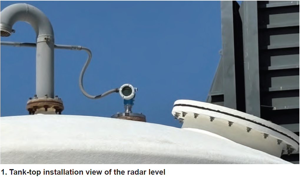

Solution. Indigo selected Endress+Hauser Micropilot FMR60B radar level transmitters to replace the aging instruments (Fig 1). The application conditions include minimal turbulence and no internal obstructions, which supports reliable non-contact radar measurement performance for tank level.

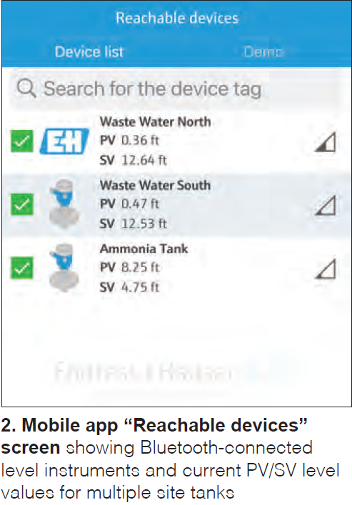

The differentiator for the site was not only updated radar technology, but also the ability to connect to the device via Bluetooth using a mobile app. Once installed and powered, technicians can access key configuration and diagnostic functions from the ground, including setup, reading values, and calibration checks, without physically attaching to the instrument at elevation.
An external display is also available. This enables level readings to be viewed from a more accessible location, improving visibility during rounds and reducing the need to position personnel near the top of the tank.
A mobile interface shows multiple tanks listed as reachable devices, with level values displayed in feet for each tag (Fig 2). A local Endress+Hauser RIA15 indicator displays level in feet. The transmitter installed on a tank-top connection, with a short cable run from the sensor head.

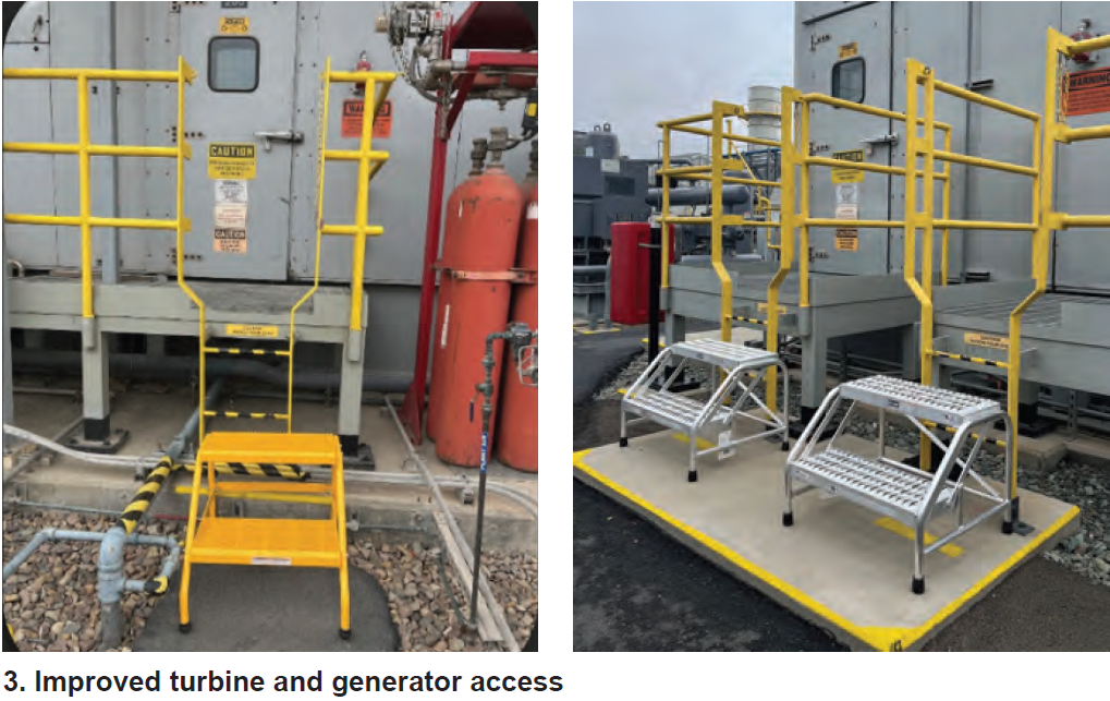

Challenge. Wildflower personnel continually look for safer ways to perform critical tasks, and this improvement demonstrated how a simple change could strengthen an onsite safety program.
Accessing the ladders to the turbine and generator platforms presented a recurring slip-and-fall risk, particularly when employees had oil residue on their boots or when rain made ladder rungs wet and slippery. The risk increased further during maintenance activities when personnel were carrying tools or equipment and could not maintain full contact while climbing.
In addition, lines routed near the base of the ladders created another hazard during ingress and egress. Personnel could inadvertently step on those lines, increasing the risk of line damage or slipping on wet piping.
Solution. The site installed small aluminum two-step ladders at the base of the ladders leading to the turbine and generator platforms (Fig 3). This modification improved access by providing a more stable transition point and helping personnel maintain three points of contact while climbing, even when one hand was occupied with tools or equipment. The solution was simple, low-cost, and easy to implement, while addressing a frequent onsite safety concern.
Results. Adding the small aluminum two-step ladders provided a safer approach for accessing the platform ladders.
The flat, serrated step surface offers better footing and grip than standard ladder rungs, reducing slip risk during wet or oily conditions. The step ladders also reduce the likelihood of stepping on lines or piping near the ladder base during entry and exit. Overall, the modification improves personnel safety during routine access and maintenance activities.
