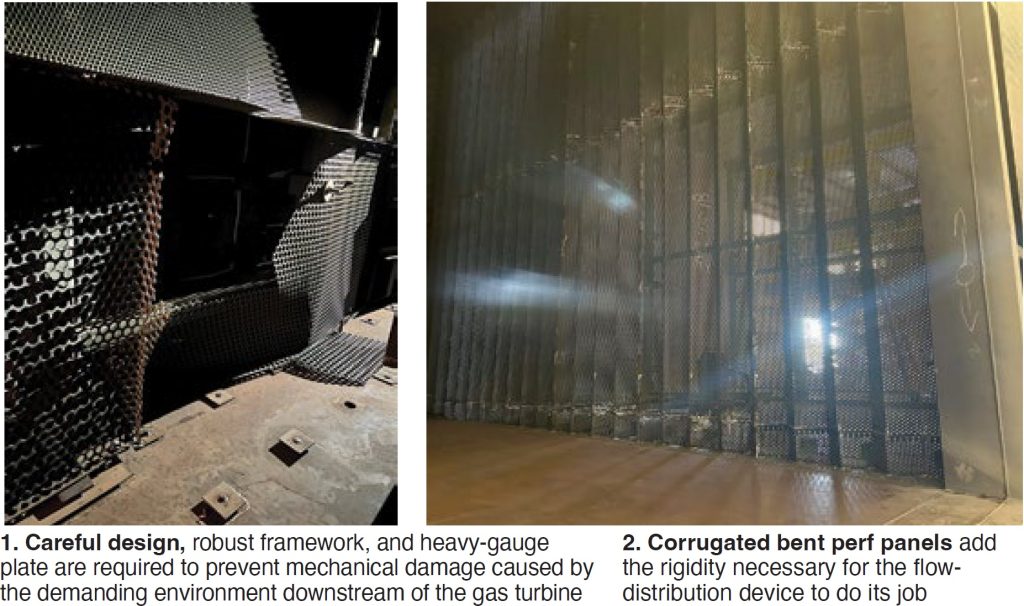

The perforated plate lives in a very torturous environment because of the high velocities, high temperature gradients, and backpressure putting mechanical and thermal stresses on the flow-straightening device and its frame. Thus, careful design, robust framework, and heavy-gauge plate are required (Fig 1). Care must be taken to manage thermal growth without binding.
Strength is important. This is why corrugated bent perf panels often are used to add rigidity to the perf-plate sheets—to stiffen them (Fig 2). Light-gauge plates and floating angle supports are not up to the task of restraining anywhere from 1 million to 5 million lb/hr of exhaust flow.
