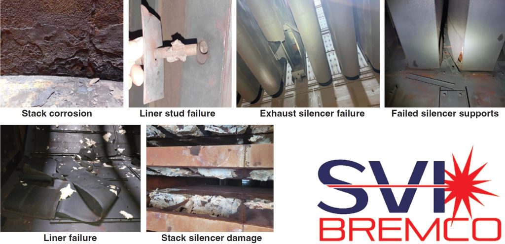

SVI Dynamics’ Scott Shreeg identified several common failure points for a steel stack to be aware of when conducting your annual inspection (photos). They are:
  • General corrosion.
  • Stress or fatigue cracks caused by repetitive or excessive movement. These usually develop at openings or discontinuities in the metal.
  • Buckling of the stack shell caused by corrosion thinning of the shell material.
  • Cracking of the stack shell and its support structure from fatigue attributed to thermal cycling.

  • Check bolts and nuts for degradation—including anchor bolts, those restraining platforms and ladders, etc.
  • Examine the following for general condition, plus any evidence of corrosion and cracks in base metal and welds:
      • Baseplate.
      • Anchor chairs.
      • Breech opening reinforcement.
      • Shell plate.
      • Circumference stiffeners.
      • Shop and field joints (welded and bolted).
      • Lateral supports.
      • Access doors.
      • Dynamic stability devices.
      • Exterior conditions of test ports.
      • Exterior lagging.
      • Expansion joints.
      • Grounding lugs and cables.
      • Guy wires (visual check for degradation and broken wire strands), cable clamps, and anchors.
      • Platforms and ladders: gratings, handrails, and platform supports.
      • Outer shell-plate coating.
      • Concrete foundation. If cracks are large, a follow-up concrete NDE may be necessary.
  • Thermal imaging is recommended when the inspection must be performed with the unit in service. It is particularly helpful for detecting areas where excessive heat transfer exists because of liner or lagging insulation loss.
Triennial steel-stack inspection
  • Visual inspection of shell plate for the full height of the stack.
  • Random ultrasonic (UT) shell-plate thickness measurements every 10 ft from the bottom of the stack to the top.
  • Follow-up with penetrant or UT inspections of questionable welds.
  • Full-height interior visual inspection, including expansion joints.
  • Drainage condition.
  • Condition of silencers and their supports.
  • Condition of turning vanes, flow dampers, and stack rain cap.
  • Visual inspection for internal floating liner sheets, studs, insulation, batten channels.
