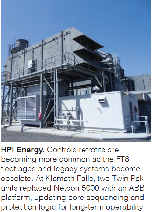

FT8 controls upgrade from Netcon 5000 to ABB
Wayne Tomlinson, HPI Energy Services
This intriguing case study described a controls modernization project for two FT8 Twin Pak generator sets at Klamath Falls, where an obsolete Woodward Netcon 5000 control system was upgraded to an ABB control platform. The work was framed as a software and integration challenge as much as a hardware changeout, because much of the existing logic was not accessible and documentation was limited.
The HPI team developed and implemented new sequencer and governor functionality on the ABB hardware while reverse-engineering operational behavior from the installed system, which required building more complex governor code with limited visibility into legacy configuration. The solution also integrated high-speed stall detection using a Rockwell ControlLogix PLC, plus bleed and variable geometry control using Woodward SPC (servo positioner controllers).
Additional balance-of-plant control elements included anti-surge bleed-air control and thrust-balance system control, intended to preserve stable compressor operation and protect rotating hardware during transients. The Klamath case was presented as an example of combining multiple control platforms and specialty functions into a cohesive FT8 package control architecture while managing obsolescence risk and maintaining operational reliability.

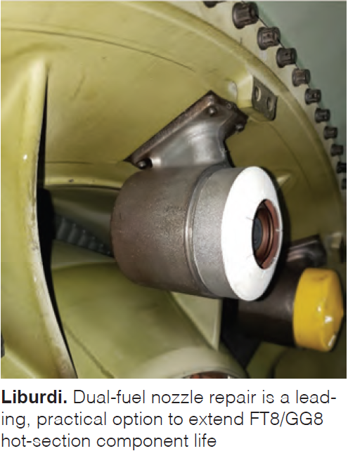

Keeping with the spirit of finding alternatives and developing solutions for the FT8 users, Tollett focused the presentation and discussion on extending FT8/GG8 hot-section component life by combining inspection, dimensional restoration, and tailored coatings and heat-treatment, rather than defaulting to replacement.
The repair scope covered gas-path hardware such as turbine blades and vanes, seal segments, combustor cans, and nozzles, with parts typically removed by an overhaul shop and shipped to a specialized repair vendor for processing.
For FT8/GG8 hardware, the workflow emphasized early intervention so internal and external coatings could be stripped, base material condition verified, and geometry restored before damage became non-repairable. Tollett framed the business around supply-chain constraints and cost: repairs commonly ran about 10%–30% of new-part cost resulting in significant cost savings.
Component-specific examples included GG8 stage 2 turbine blade repair development and GG8 stage 1 vane damage investigations. In the vane case, metallography indicated high-temperature oxidation in a cobalt-based vane alloy and recommended selection of more oxidation-resistant repair and coating systems. The FT8/GG8 services list also included dual-fuel fuel-nozzle work and combustion-chamber repairs. Needless to say, the end users in attendance were filled with intrigue on these developments.

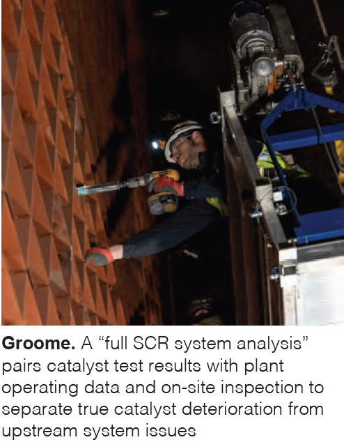

Catalyst cleaning
Matt Cohen, Groome Industrial Service Group
Cohen reviewed how SCR and CO catalyst systems in FT8 applications lost performance when flow, temperature, or reagent distribution became non-uniform, and how targeted maintenance restored conversion while controlling backpressure. Key contributors to degraded catalyst effectiveness were described as poisoning (for example alkali and alkaline earth compounds), fouling by dust and fly ash, thermal phase change, moisture exposure on susceptible catalyst types, and mechanical issues such as damaged seals, insulation blockages, and ammonia control problems.
A structured catalyst maintenance program was outlined around inspection and testing, cleaning interventions, and follow-up verification using operating data and differential-pressure trending. For SCRs, the discussion emphasized vacuuming and regulated-air cleaning to remove masking and plugging, plus repacking and restacking to preserve a uniform face and limit bypass that could drive conversion loss and structural damage.
For CO catalyst, acid washing and regasketing were presented as options to reduce backpressure, improve conversion uniformity, and extend catalyst life. Ammonia injection grid (AIG) reliability was tied to lance, header, and vaporizer cleaning, followed by tuning using permanent sampling grids to map maldistribution by zone and confirm improvements.

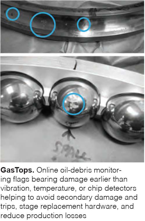

Monitor bearing health with confidence
Simon Wilson, Gastops
Wilson explained why traditional bearing damage indicators in aeroderivative packages often provided little usable pre-warning, and why missed or false events could drive forced-outage hours and costly secondary damage. He reviewed the progressive nature of bearing surface fatigue and noted that debris generation rate depended on load and speed, while particle counts correlated to damaged area and particle-size distribution remained largely independent of bearing size.
Condition-monitoring theory was framed around shifting from reactive detection (seconds to minutes) to proactive protection (days to months), enabling maintenance planning inside the P–F interval. The talk then described an in-line oil-debris monitoring approach that measured metallic particles in a flow-through sensor before filtration, distinguishing ferrous and non-ferrous signatures and trending cumulative debris, composition, and size profile to support “safe to operate” and remaining-life estimates.
Configuration options were outlined for multi-sensor installations on scavenge returns (including inside an FT8 package) or a single-sensor approach on a common scavenge return, with electronics located outside the package. Case examples cited multi-day planning windows ahead of a power-turbine bearing event, reduced production loss by scheduling around low-demand periods, and avoided secondary damage through controlled operation.

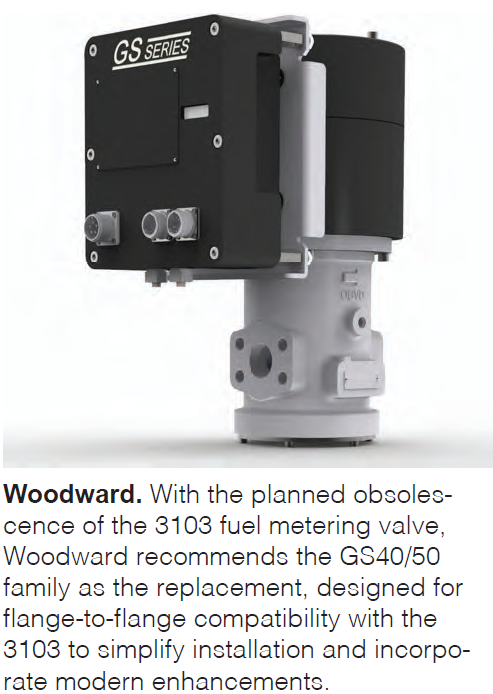

Controls obsolescence and new products
Matthew Ryan, Woodward
The session reviewed lifecycle support considerations for FT8 control-system and fuel-system components, with emphasis on planning maintenance to avoid forced outages. It described why overhauling control hardware in advance of repair reduced operational risk by converting high-cost, unplanned events into scheduled work with reserved capacity and parts, and by returning assemblies to “zero-hour” condition through replacement of wear items such as seals, bearings, and gaskets.
Recommended overhaul intervals were aligned to turbine OEM schedules, cited as 50,000 hours or six years, and contrasted with run-to-failure outcomes that typically carried higher outage cost.
Ryan also summarized recent control-system obsolescence history, noting the end of regular production for LON LinkNet in April 2015 and its replacement by LINKnet-HT modules with higher I/O density and environmental robustness. LINKnet-HT capabilities highlighted included a wide ambient temperature range (−40 to 100C), high vibration tolerance (8.2 Grms), shock rating (40G), improved isolation, and options for redundant CAN communication.
Fuel-system lifecycle risk was addressed through the 3103 fuel-metering valve support timeline and the transition path to GS40/50 hardware and service tooling connectivity.

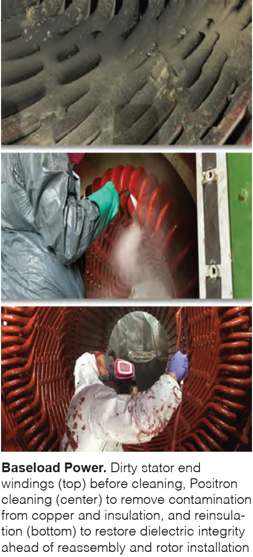

FT8 overhaul workflow
Robert Vandenabeele, Baseload Power
The presentation summarized an FT8 major-inspection and overhaul workflow, from package access through generator and excitation repairs, and tied it to facility capabilities needed to execute heavy maintenance safely and repeatably. The overhaul process was described as starting with roof removal and engine lift preparation, followed by power-turbine (PT) removal and staging for rotor extraction.
The rotor was then pulled and transferred for cleaning and refurbishment steps, including stator cleaning, removal of heavy contamination (“dirty stator” condition), and positron cleaning.
Electrical restoration work was described as including reinsulation prior to reassembly, with the rotor shown “ready” before reinsertion and final alignment activities. The closeout scope highlighted PT shaft alignment as a critical step to protect bearings and avoid repeat vibration issues after reassembly.
Vandenabeele also covered support work on excitation and controls, including AVR A30 repair using a test rig and decision logic to repair or replace control cards, monitor cards, and auxiliary boards. Parts readiness was emphasized with examples of consumables and spares such as shaft seals, hoses, RTDs, heaters, gaskets, fuses, diodes, lube-oil pumps, and spare bearing-exciter components.
