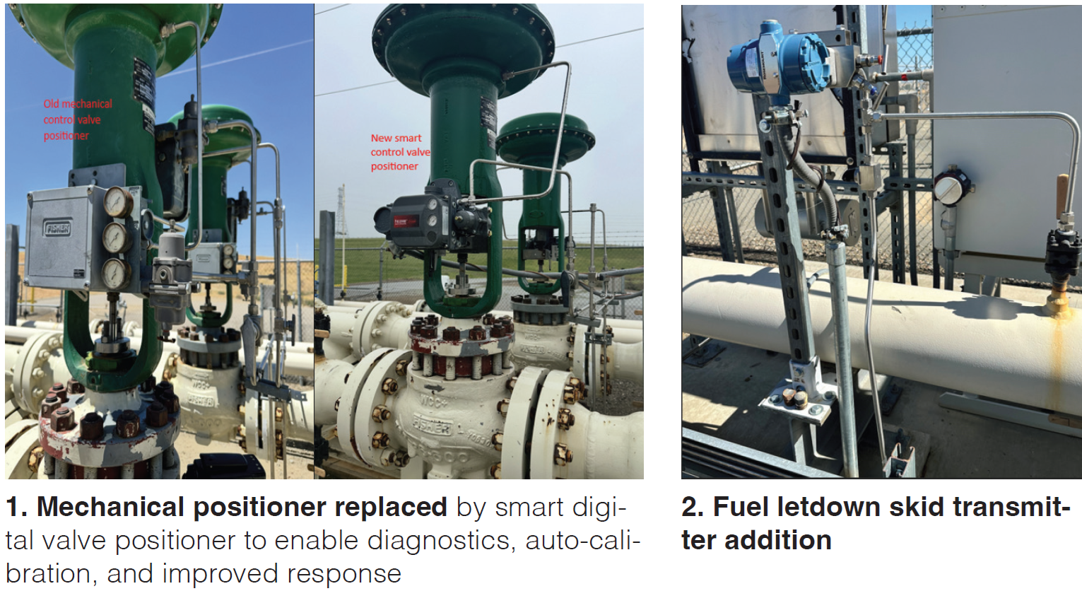

- Mechanical positioner limitations. The legacy Fisher mechanical valve positioners required manual tuning, often with the valve out of service for extended periods. They also offered no remote access, no straightforward integration into modern monitoring, and less precise response than digital positioners.

The team replaced the Fisher mechanical valve controller/positioner with a Fisher FIELDVUE DVC6200 Series smart digital valve positioner (Fig 1). Three practical benefits result:
- Faster, repeatable tuning and auto-calibration, reducing time the valve must be removed from service
- Built-in diagnostics to support troubleshooting and maintenance planning
- Ability to capture valve and process behavior in a historian for condition monitoring, including response time and travel deviation

A second pressure transmitter was added at the fuel letdown skid outlet to support redundant control and alarming (Fig 2). Dual-transmitter function block logic and HMI faceplates were implemented in the plant BOP Ovation DCS for monitoring and alarms.
