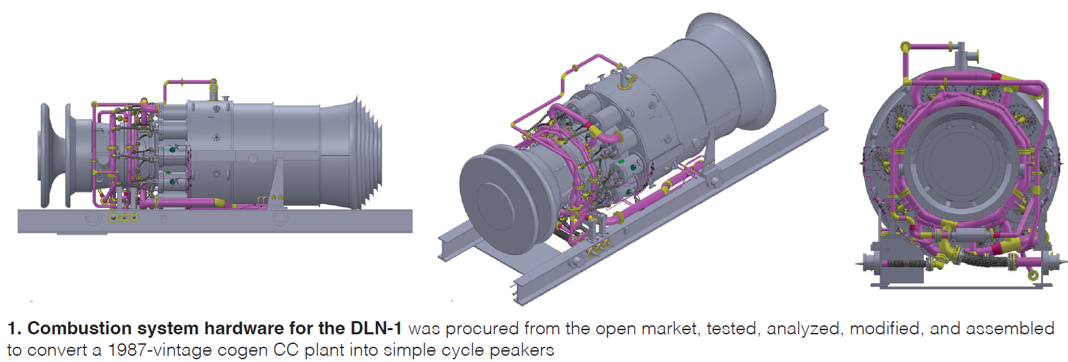

TOPS’ Jeremy Four notes that many 7EAs are equipped with DLN-1 systems (Fig 1) today but the units had a legacy dual fuel combustion system. What distinguishes these GTs is that the combustion system was assembled from both new and used components sourced from multiple locations. For example, end covers, secondary fuel nozzles, flow sleeves, transition pieces, and liners are refurbished/repaired aftermarket parts; primary gas tips, casings, inner and outer crossfire tubes, and bullhorn brackets were new (at installation time).

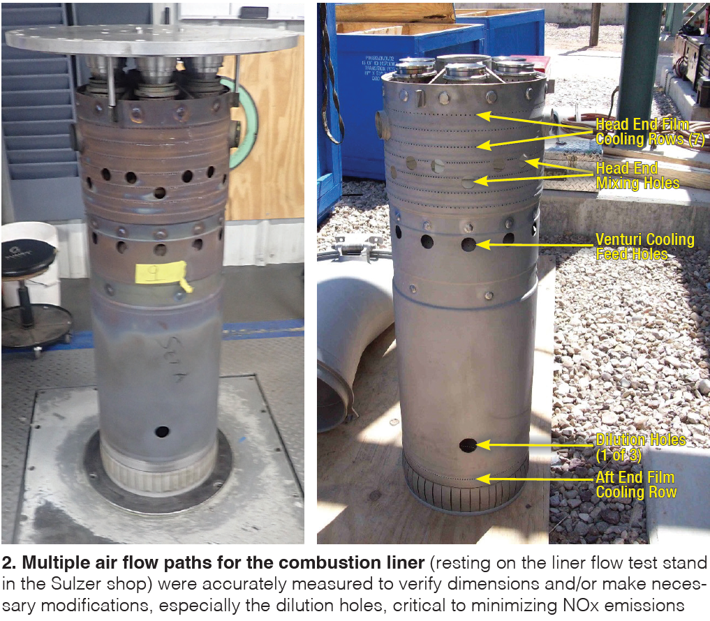

TTS’ Mitch Cohen went deep on this point. “Fuel nozzles get flow-tested all the time, and all the repair shops have this capability. But the flow testing of liners we needed for this project required a test stand that can provide much larger flow volumes than required for fuel nozzles or standard liner flow testing.” Cohen, a combustion engineer, began his career in the GE development lab. His intimate knowledge of GT combustion is captured in Combined Cycle Journal articles going back to the early 2000s.
He explained that, at the Sulzer shop, the liner sits in a test stand on a hole in the floor (Fig 2), beneath which is a fan sucking air through the cylinder. The outside surface of the liner is at atmospheric pressure;  the inside of the liner is at negative pressure; a venturi-type flow meter measures the flow through the liner. Combustor liners have holes creating many flow paths. By opening and closing different sets of holes, you can obtain the effective areas of each flow path, which then go into a combustion flow model.  When fuel flows are added, the model predicts flow, pressure, and temperature distributions through the combustor, which, in turn, are used to predict NOx emissions.
Andrepont added that the liner flow test stand is calibrated annually to an EPRI standard; thus measurements are accurate and repeatable. Unique “fake” end-cover assemblies allow measurement of leak-by as well, necessary for accurate total flow testing.
When you procure parts from multiple sources, you have to validate the dimensions of the holes and the flows through each, says Cohen, then put them together to verify that you have accurate primary and secondary air flows and therefore proper fuel/air ratios. But the dilution holes, three holes drilled at the aft end of the liner spaced 120 deg around the perimeter, are where you can adjust the NOx levels.
Much of the hardware came from APG, who supplied two sets of primary and secondary fuel nozzles, flow sleeves, transition pieces, outer combustion chambers, and installation hardware, plus one set of combustion liners. “We purchased two sets of combustors and liners from two sources. It turned out that the dilution holes in one set were way too big for this application. The fix was to reduce the hole size. Not only does the NOx level have to comply with the TEQC standard, but the combustor also has to handle seasonal variations and changes arising from equipment degradation over time. So, really, you’re looking to achieve a NOx level less than 9 ppm.”
Flows through the venturi cooling holes also didn’t match up between the two liners so these had to be corrected as well.  It turned out that the fuel nozzles’ effective areas from both sets were also too large, so TTS manufactured new primary nozzles because discharge holes are integral to the nozzle body and can’t be made smaller. APG was able to modify the secondary nozzles by cutting off the radial fuel injection pegs and welding on new pegs with smaller discharge holes.

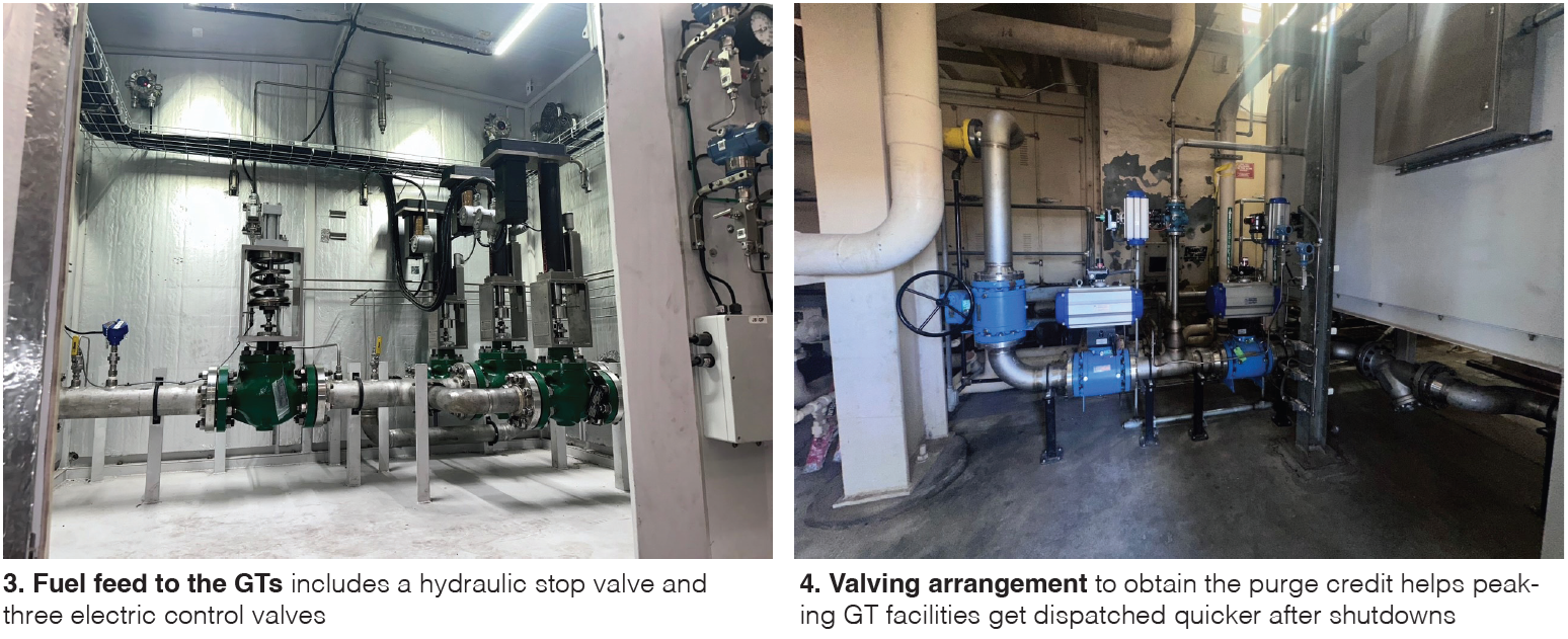

Other hardware procured to complete the combustor system included igniters and flame detectors; primary, secondary, and transfer gas manifolds and pigtails; fuel metering skids to direct the fuel into the three lines (Fig 3) feeding the combustor (with TTS electric control valves); and a  “purge credit” compliant valve configuration to eliminate the unit purge requirement for faster dispatch (Fig 4).

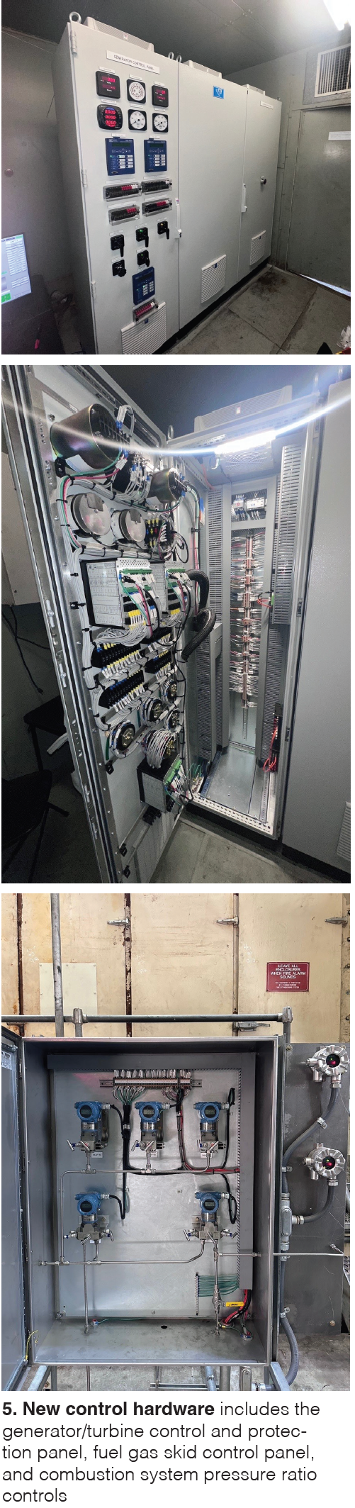

The obsolete Mark IV controls were replaced with a TTS redundant TMS-1000R turbine control system (Fig 5) built on the Allen-Bradley ControLogix, PLC-based architecture, along with monitoring and protection I&C. Control of the remaining legacy balance-of-plant (BOP) systems and I/O needed to operate the plant in simple cycle were migrated from the obsolete Infi90 DCS and integrated into the ControlLogix system.
