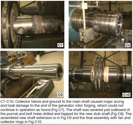

Case Study No. 3. A generator experienced a collector failure and ground to the main shaft that caused major arcing and heat damage to the end of the generator rotor forging (Fig C7). The amount of damage and heat-affected material made the shaft end forging unacceptable for continued operation. Stub-shaft replacement was proposed and accepted by the owner.
This was a major undertaking. The shaft was severed just outboard of the journal and bolt holes drilled and tapped for the new stub shaft (Fig C8). The assembled new shaft extension is shown in Fig C9, and the final assembly with the fan and collector rings in Fig C10.
To conclude, negative sequence events and ground faults are preventable by good operation and monitoring equipment. When those defenses fail, considerable damage can occur. However, it does not always mean that the damage cannot be repaired and the unit returned to service. These case studies show that even when there is damage, advanced welding and machining processes can restore the unit to service relatively quickly.

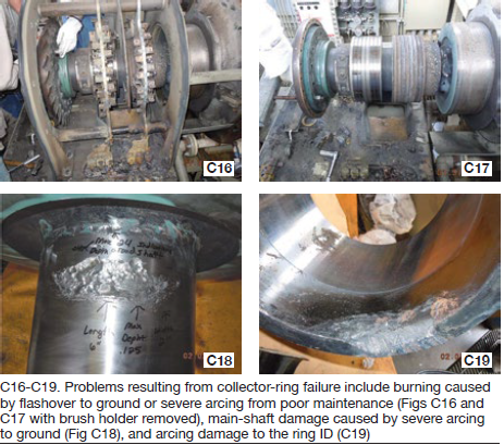

Failure. Typical problems resulting from failure are seen in the photos C16-C19. In the first, the right ring was severely burned by a flashover to ground or severe arcing from poor maintenance. The adjacent image shows a similar condition but with the brush holder removed. Fig C18 is of damage to the main shaft from severe arcing to ground, C19 shows corresponding arc damage to the ring inside diameter.

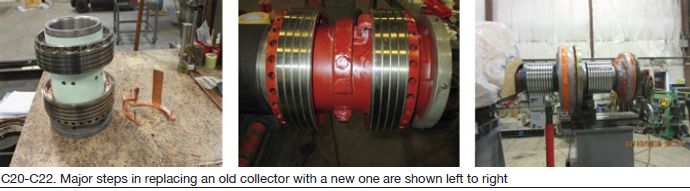

Repairs. Figs C20-C22 illustrate steps in replacing an old collector with a new collector, Fig C23 is of a grinding operation for truing a worn, or new, ring.

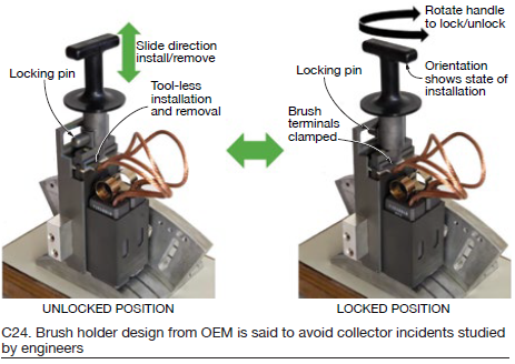

The presentation closed with a discussion of brush-rigging upgrades. GE was said to have a well-defined set of brush-holder design criteria, including the following:
    • Allow for safe installation and removal of brush holders with the generator online.
    • Improve ease of brush and spring replacement—no tools required.
    • Eliminate brush “hang-ups” within the holder by having a fully supported brush and a smooth/slick brush pocket.
    • Decrease the risk of flashover.
    • Decrease susceptibility to brush current selectivity—that is, uneven current distribution among brushes.
    • Allow easy integration for both servicing and replacement across all GE generator models.
The company’s most recent brush-holder design for generators of moderate size (Fig C24) was said to meet these criteria.

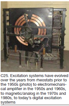

If you were relatively new to the industry, listening to the presentation by Basler Electric Co’s Richard Schaefer at GUG 2017 provided valuable perspective on excitation systems. A former chair of the IEEE PES Working Group, he’s “seen it all” in more than four decades of service to power producers. His CliffsNotes on the evolution of excitation systems:
    • Before the 1950s, rheostats (Fig C25).
    • 1950s and ‘60s, amplidyne.
    • 1970s and ‘80s, magnetic/analog.
    • Late 1980s through today, digital.
Several factors affect how quickly systems become obsolete, he said—including, available materials, present technology, and available software. Examples of materials availability issues: carbon composition can no longer be manufactured, warlords have taken over the mines, material determined to be hazardous. Examples of hardware availability issues: primitive computers, present-day powerful computers.
Schaefer note actions that have contributed to the slowing of obsolescence—for example, purchase of components from manufactures serving major long-survival industries (such as automotive), redesign of product with new components where practical, purchase large volumes of obsolete components.
Particularly in recent years, there has been upward evolution in software. For example multilingual capability, built-in powerful testing tools, enhancements to speed commissioning. Also there are options to facilitate retrofit—for example, replacement product fits into same location, provide replacement excitation cabinets but keep the power potential transformers, keep SCR bridges and provide new front-end electronics.

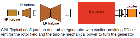

Andre Tetreault, director of tests and diagnostics at VibroSystM, and co-author Bernard Lemay, PEng, the company’s Zoom analytical software expert, opened their presentation by reminding the GUG 2017 audience that, in the ideal, the generator shaft should be electrically and magnetically neutral during operation. The use of ferromagnetic materials in the construction of the shaft makes this component extremely conductive and subject to current flow and induced voltages. A typical turbine/generator configuration is shown in Fig C26; the exciter provides DC current for the field, the turbine provides mechanical power.
At least one generator bearing is insulated from ground. On other bearings, a thin oil film is the only barrier separating the shaft from the ground and this film may not act as insulation to current flow.

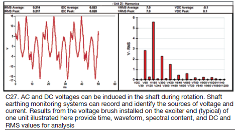

Both AC and DC voltages can be induced in the shaft, causing potential damage to the unit— especially the bearings. Shaft earthing monitoring systems can record and identify the various sources of voltage and current, allowing for analysis and damage prevention. One brush is installed to monitor voltage (diagnostics), usually on the generator exciter end, and one to monitor current (protection), usually on the turbine end.
Results from the voltage brush are shown in Fig C27. Time, waveform, spectral content, in addition to DC and RMS values, are available for analysis. Alarm levels are set after results are analyzed.
Protection schemes using trends of shaft currents are common, but do not provide diagnostics. In many cases, alarms triggered will confirm existing damage, instead of detecting ongoing issues and/or preventing future damage. Voltage frequency profiles should not evolve over time.
High-speed data acquisition, and comprehensive diagnostics software, allow for in-depth analysis of harmonics to identify various anomalies. Patterns such as high even harmonics may indicate rotor alignment or stator bar problems. If deviations are present, other symptoms may include stator vibration and/or bearing temperature variations.
High DC levels should trigger a ground connection investigation and if the shaft is magnetized, bearing temperatures should be verified.

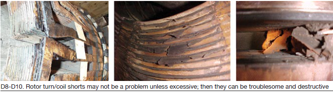

    • Rotor turn/coil shorts. Shorts may not be a problem unless excessive and you run out of current, or if they result in high thermal-sensitivity vibration. But they can be destructive (Figs D8-D10).
      • Thermal sensitivity can be problematic. It causes rotor vibration to change as the field current is increased and can cause rotor bowing when (1) the temperature distribution is uneven circumferentially around the rotor and/or (2) axial forces are not distributed uniformly in the circumferential direction. The phenomenon, characterized by a once-per-revolution frequency response, may limit operation at high field currents or VAR loads because of excessive rotor vibration.
      • Shorted-turn detection. The most reliable method for detecting shorts is by use of a flux probe. The technology is well understood and reliable.

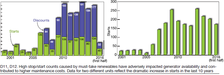

    Generators built during the gas-turbine order/installation “bubble” in the late 1990s and early 2000s, look very much like their predecessors built in the 1950s, 1960s, and 1970s. However, unlike their predecessors, the newer machines are not giving the 20 to 30, or more, years of reliable service expected.
    OEMs have designed similarly sized machines for MVA ratings 40% to 50% higher than their predecessors, while pushing material capabilities to their maximum. Plus, demands on equipment have been exacerbated by the need to cycle these generators hundreds of times annually to accommodate must-take renewables.
    Generators were designed to run at base load or, worst case, for minimal annual start/stop counts—perhaps 50 to 75. However, as the charts in Figs D11 and D12 for two case histories show, they are seeing 250+ starts per year.  Units in renewables-heavy markets are exceeding 350-400 annual starts. This takes low-cycle stresses from thermal expansion/contraction, and moves it into a high-cycle realm.  The end result is that units are either suffering in-service failure or, at a minimum, are requiring very costly repairs or maintenance/upgrades at their first major outages, within 10 to 15 years.

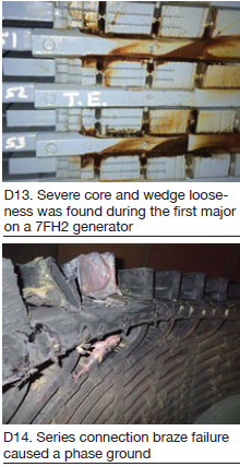

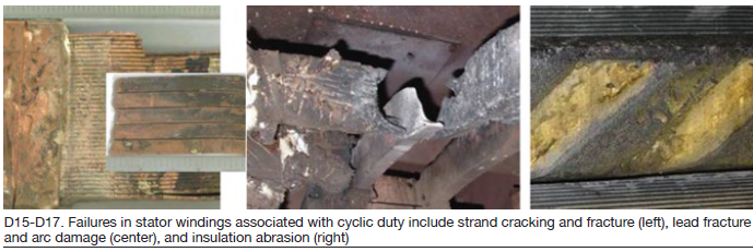

    In his presentation, AGT Services Inc’s Jamie Clark pointed to common weaknesses exacerbated by these high cycling operations—including loose stator wedge systems (Fig D13), axially loose core iron, loose endwindings, global endwinding dusting or broken ties, loose belly bands, bar movement in the stator slots, high partial discharge and resulting corona damage, and increased opportunities for seal-oil problems resulting in oil entering the unit, which further accelerates the previous issues.
    In the field, the impact is found in cracked or failed main leads, pole/pole and coil/coil crossover jumpers, migration of slot armor, deformation of field endwindings, loose/missing/broken distance blocking, migrating coils, insulation, or amortisseur springs resulting in blocked cooling, thermally sensitive fields, rapid turn short development, and myriad other issues (Fig D14).

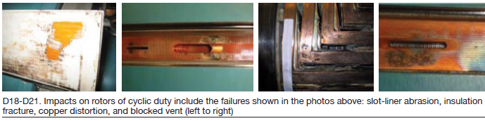

    Cyclic duty involves start/stop operation, load cycles, and power-factor changes. Impact on stators includes vibration transients, thermal and mechanical stresses, and core-end heating. Some of the effects on stator windings and core are high- and low-cycle fatigue, insulation abrasion, strain, shorts or grounds, localized overheating, and core-iron melting. Typical failures are strand cracking and fracture (Fig D15), lead fracture and extensive arc damage (Fig D16), and insulation abrasion (Fig D17).
    Cyclic-duty impact on rotors includes copper distortion, insulation breakdown, shorted turns, connector failures, grounds and forging damage. Typical resulting failures are shown in Figs D18-D21: slot liner abrasion, insulation fracture, copper distortion, and blocked vent (left to right).
    Twenty-five-year GE veteran Ed Winegard, currently principal engineer for armatures, described for attendees several design features developed to accommodate cyclic operation. You can access a copy of Winegard’s PowerPoint on the Power Users website.
    Maintenance and inspection suggestions for cyclic duty, also covered in the presentation, include the following:
