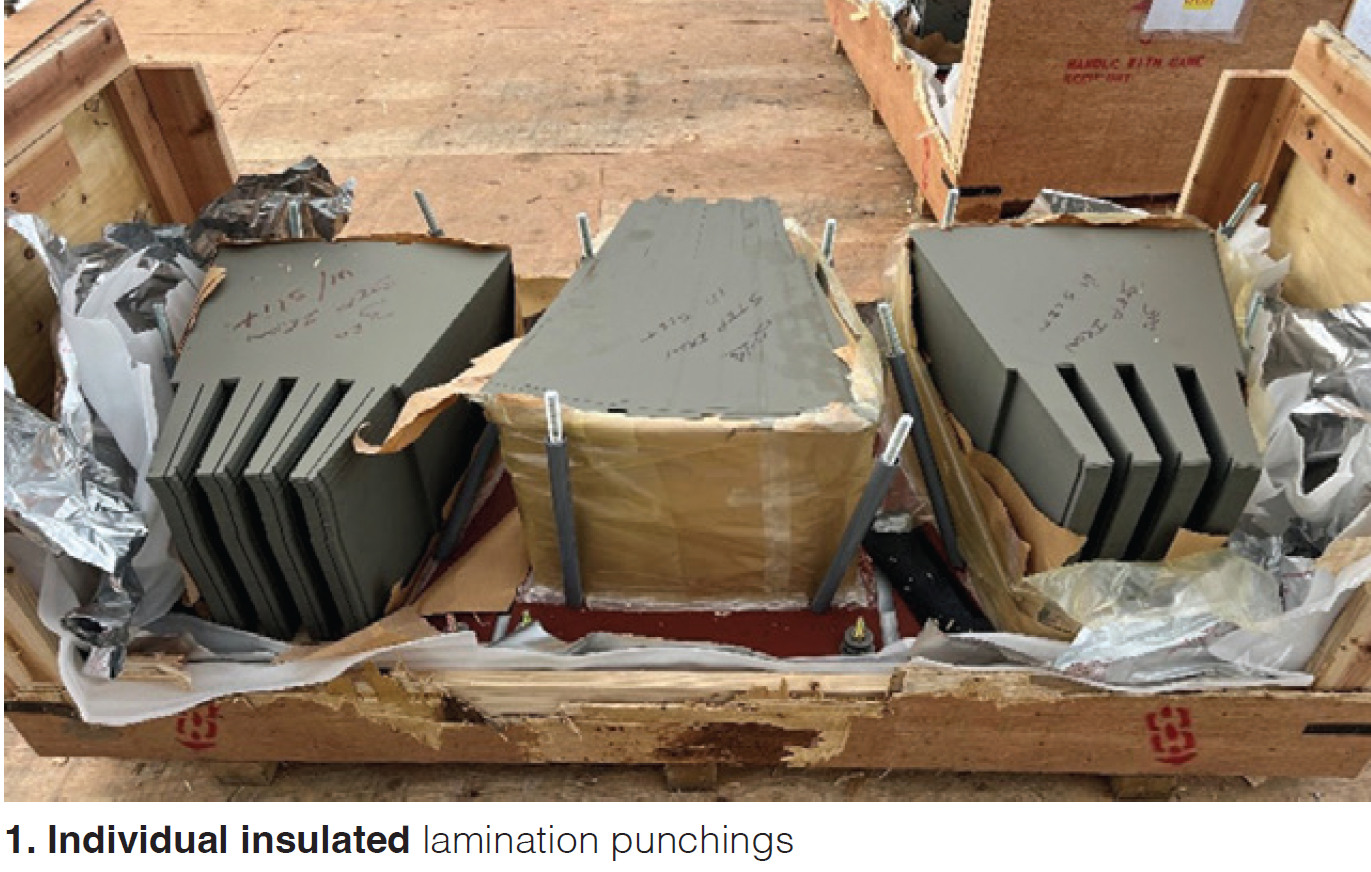

The stator core consists of thin, insulated metal laminations, approximately 0.014 inch thick, stacked circumferentially in an interleaved pattern. Each lamination is coated with an insulating varnish to prevent eddy-current formation and interlaminar electrical contact (Fig 1). The core is typically assembled vertically, beginning at the connection end (CE) and building toward the turbine end (TE), where it is axially compressed via key bars to achieve uniform tightness across the stack (Fig 2). Ventilation ducts are distributed between the core sections to channel hydrogen coolant through the core and around the winding, ensuring efficient heat dissipation during operation.

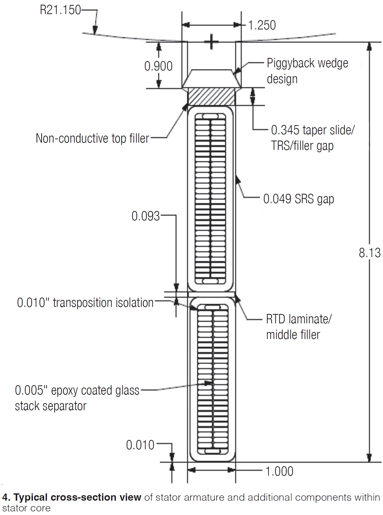

Within the core, stator slots accommodate the copper armature bars. Each lamination includes open slots for the bars and dovetailed grooves for the wedges that secure them. The stator winding is composed of insulated copper bars transposed using the Roebel method, which ensures each strand alternates through every radial position along the bar. This design equalizes magnetic flux exposure, minimizing circulating current losses under load and promoting thermal balance along the length of the coil.
Each stator bar receives a multilayer insulation system forming the “ground wall (Fig 3).” This system typically uses mica tape bonded with a thermosetting epoxy or resin binder. During manufacturing, the bars are placed in a vacuum-pressure impregnation (VPI) tank, where pressure and heat cycles remove volatiles, compact the insulation system, and cure the binder. The result is a dense, void-free dielectric barrier with excellent mechanical strength and thermal endurance (Fig 4). The insulation is rated to maintain dielectric integrity across the full expected temperature range for hydrogen-cooled service.

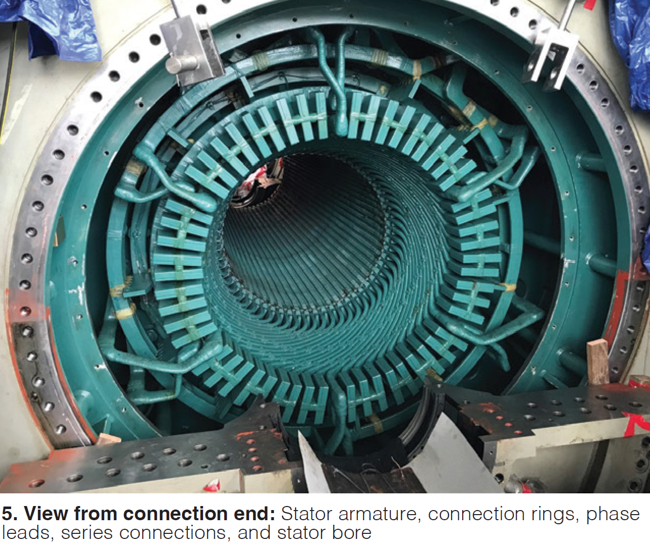

To reduce abrasion within the stator slot, the bars are wrapped in armoring tape, while voltage-grading coatings extend several inches beyond the core to reduce corona discharge. At the end-turn region, the coils are bound by molded fiberglass rings, supported by the stator core flanges and secured with thermosetting resin. Conformable materials are added to evenly distribute mechanical stress, and all components are bonded into a solid structure designed to withstand thermal expansion and electromagnetic forces during operation. Finally, the armature bars are locked into position by wedges driven into the dovetail slots, completing a tightly secured winding assembly (Fig 5).

  • Stator armature issues. Vibration-related mechanical wear, thermal distress, fatigue spark erosion, ground faults, loose wedges, insulation dusting or greasing
  • Stator core issues. Shorted laminations causing local hot spots, back-of-core burning, iron fretting, and in rare cases, melting
  • General assembly issues. Dry-tie dusting, loose end-winding axial support hardware, core-iron manufacturing inconsistencies, and generator terminal-enclosure weatherization problems leading to moisture ingress
