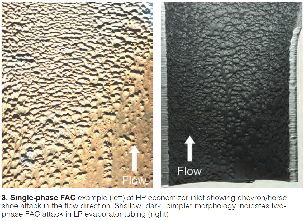

Flow-accelerated corrosion (FAC). Still the leading HRSG failure mechanism and a safety issue in fossil feedwater lines. It is necessary to differentiate single-phase from two-phase FAC as they are controlled by different cycle chemistries. Apply AVT(O) or OT for single-phase locations, raise pH25 (to ~9.6–9.8 as needed) for two-phase zones, and verify that the levels of total iron are in agreement with the IAPWS achievable guidance values (TGD6-13 (Corrosion Products)). Avoid reducing agents in HRSG service.

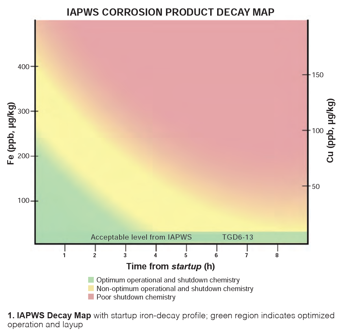

IAPWS Decay Map for startups. For fast-start/frequently started units, plot the startup iron-decay profile (using a proxy technique such as turbidity correlated to total Fe) and overlay the profile on the IAPWS Decay Map. Profiles in the “Green” area of the decay map indicate optimized operation and layup; profiles in the “red/yellow” area indicate high iron transport into boilers and possible elevated internal deposit levels which can initiate UDC (under-deposit corrosion). The white paper details procedures and use cases including ACC fleets and FFS verification.

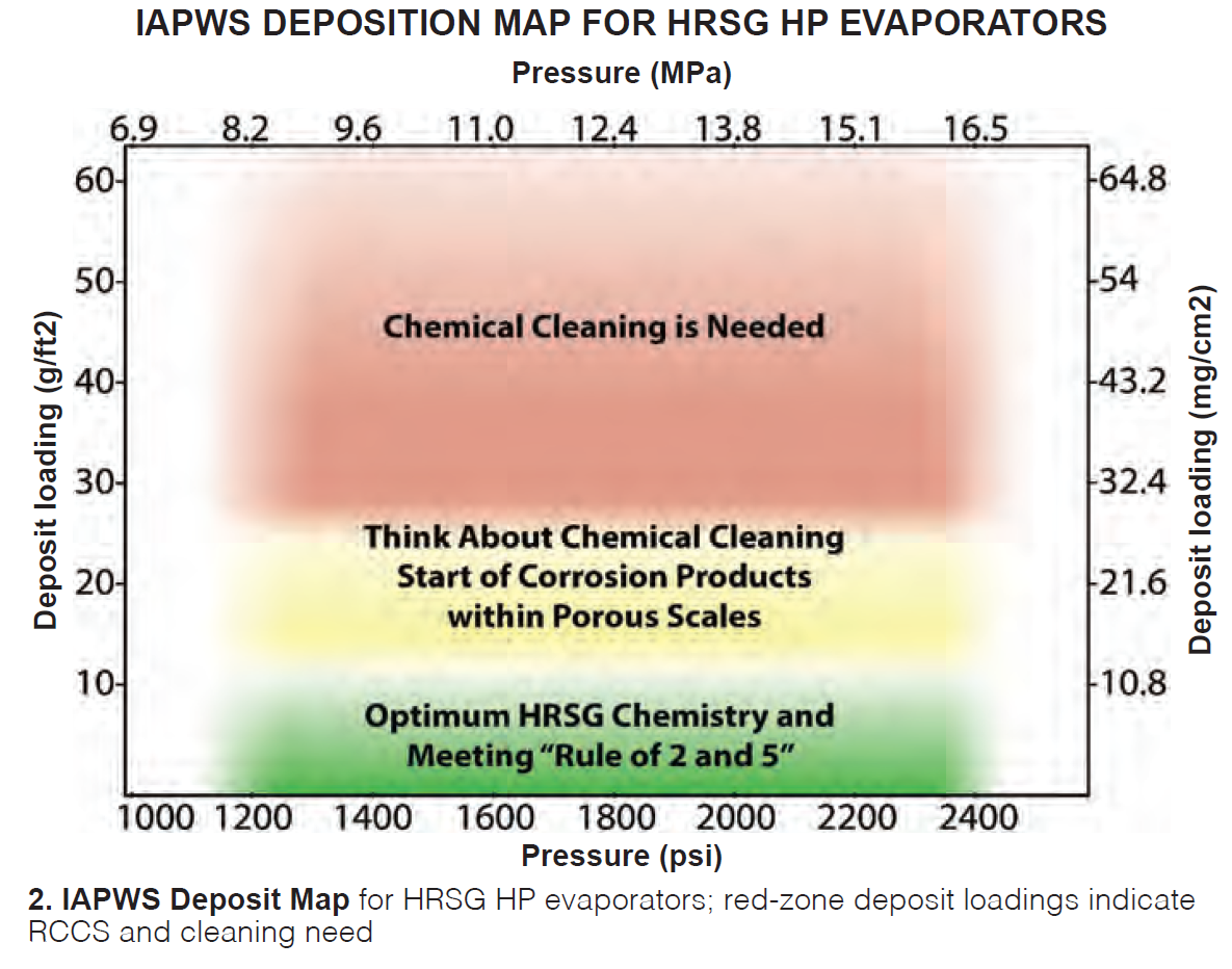

IAPWS Deposit Map for HP evaporators. Remove lead-tube samples (initially within the first ~20,000 operating hours) and place measured deposit loading on the map to determine cleaning need. Red-zone results indicate an RCCS and elevated UDC risk. A strong warning for use of a film-forming substance (FFS) indicated that an FFS should not be applied with heavy deposits in the red area of the deposit map. The IAPWS FFS Guidance (TGD11-19) suggests that deposits are characterized before application of an FFS (Section 8 review).

  • Trend total Fe and use the Decay Map to tune startup and layup; improvements are when the profiles move into the green area with procedure and chemistry changes.
  • Inspect deposits with the IAPWS Deposit Map, schedule cleaning on evidence, and verify results with post-clean Fe trending.

  • FAC control. Don’t rely on oxygen addition to solve two-phase FAC; increase pH and verify by iron trending. Identify the FAC type by surface morphology before addressing any chemistry changes.

View the webinar recording above to see example Decay Map overlays, deposit/reaction-product micrographs, and FAC morphology side-by-side (Fig 3), useful visuals when educating station leadership and maintenance teams.
