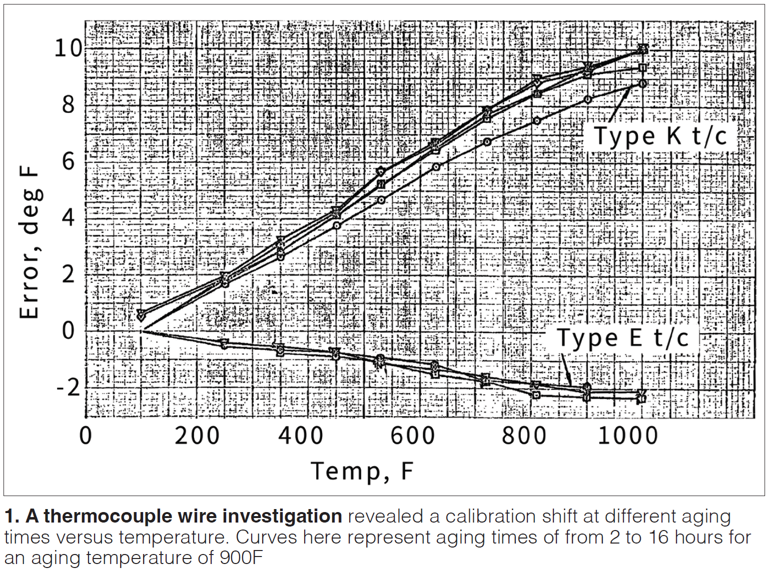

A GE Evendale (Ohio) report issued in 1977 noted that when Type K thermocouples were used in the 900F–1000F range their calibration shifted to indicate a higher temperature than actually existed. The phenomenon is metallurgical in nature. Conclusion: The thermocouple “ages” with temperature cycles, and the calibration shifts (Fig 1).

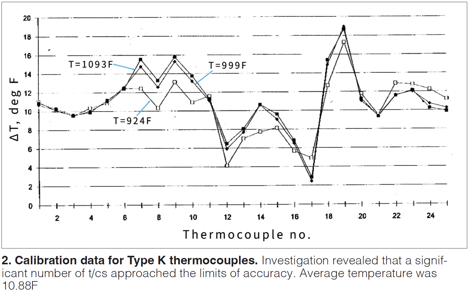

In 1993, a Performance Task Force (PTF) was formed to investigate the actual accuracy of thermocouples received. Result: A significant number of t/cs were found to approach the limits of accuracy (Fig 2).
A result of the PTF’s findings was that the value of the constant TTKXCOEF was revised from 0.995 to 0.989. This corresponded to a calibration difference of 12.1 deg F. The conclusion was to use only precision Type K (CrAl) thermocouples with an expected accuracy of +4.4 deg F at 1100F.

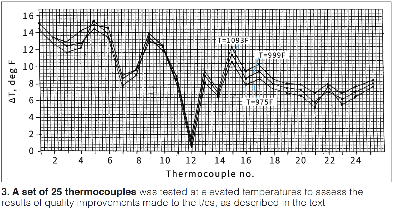

After 1995, all turbines shipped were outfitted with precision Type K thermocouples. The OEM issued Technical Information Letters (TILs) recommending the replacement of standard Type K t/cs with precision Type K instrumentation. Vendor quality was improved by assuring dimensional and material consistency of the wire material and heat treating after swaging. A set of 25 t/cs were tested at elevated temperatures to assess the results of improvements (Fig 3).
The out-of-limits reading for t/c 12 indicates a defective sample. The average error to the calibration temperature was 10.0 deg F. The expected error of precision t/cs is +4 deg F. With the exception of No. 12, all thermocouples were within the expected accuracy.
