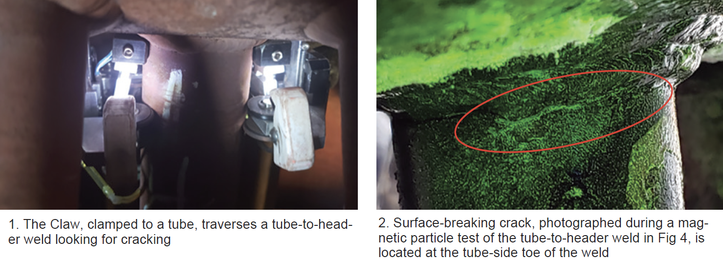

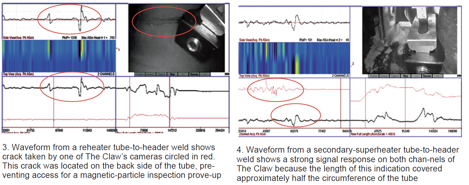

A relatively new tool for inspecting tube-to-header welds, “The Claw,” developed by TesTex Inc, Pittsburgh, uses the Balanced Field Electromagnetic Technique (BFET) to detect cracking on the surface, and below it to depths of 0.250 in. (Figs 1 and 2). It was on display for viewing by owner/operators of heat-recovery steam generators at the 2019 meeting of the HRSG Forum with Bob Anderson.
Over the last couple of years, TesTex technicians have gained a great deal of experience with The Claw and are now able to examine up to about 200 tube-to-header welds in one shift. Fig 1 shows the BFET’s two sensors spaced 180-deg apart and companion cameras traversing the full circumference of the weld. Important: No surface preparation is needed to perform the BFET inspection in HRSGs (Figs 3 and 4).
