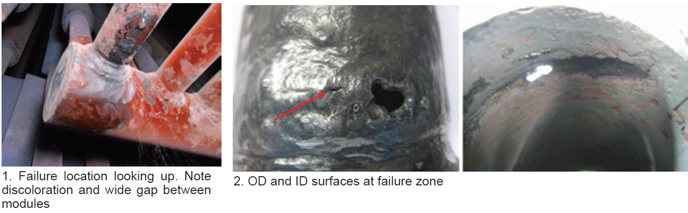

Reheater tube failures were examined for a 760-MW 2 × 1 combined cycle commissioned in 2002. The subject three-pressure, three-module HRSG does not have duct burners.
This presentation of a unique reheater-tube failure mechanism may be the precursor of many future mid-life failures in other HRSGs. The tube adjacent to the gap between modules, and entering the lower outlet header horizontally, had clearly overheated as shown by the large internal oxide growth and exfoliation data base (Figs 1 and 2).
Metallurgical reports showed multiple circumferential and transgranular cracks at the ID of the tube, beyond the heat-affected zone, progressing toward the outside.
Discussions and details led to observations of progressively more rapid localized oxide growth and exfoliation (OGE). Various hypotheses and further analysis steps were reviewed. The key takeaway was the following proposed sequence of events:
1. Normal steam-side oxide growth during years of operation.
2. As oxide thickens and insulates the tube internal surface from the steam, tube metal temperature increases, as does the oxide growth rate.
3. Tubes adjacent to the mid-module and sidewall gap operate hotter, and grow oxides faster than other tubes.
4. Eventually the oxide buildup reaches a critical thickness and it exfoliates.
5. In the case described, exfoliated oxide plugged, or partially plugged, the horizontal section of tube resulting in severe overheating.
6. Severe overheating and thermal-transient-driven strain at the failure site further accelerated localized OGE, thinning the tube wall and resulting in failure.
