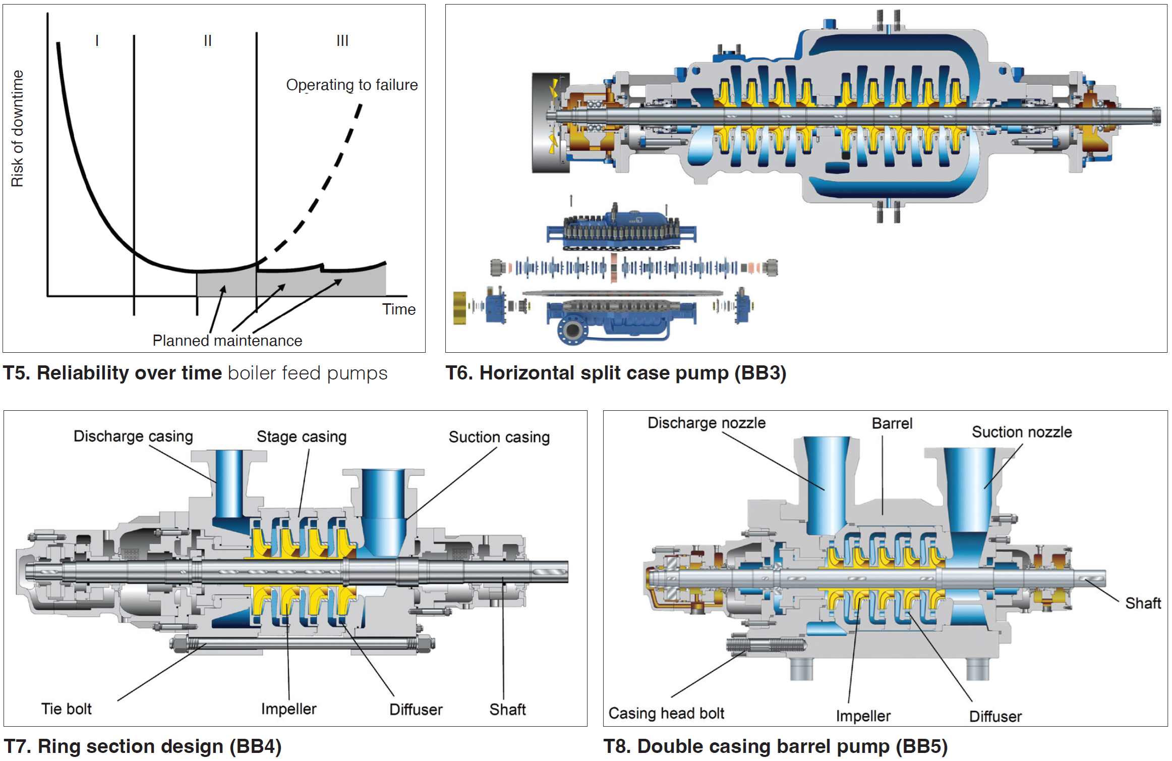

An interesting point: “Pump installation and startup is the highest risk point in the life of the pump,” he said. “Proper operation has a big impact on the life and maintenance requirements” going forward. He also recognized “support from the OEM (Fig T5).”
Fischer then focused on the types of multistage pumps (Figs T6-T8):
  • Horizontal split design (BB3).
  • High pressure ring section (BB4).
  • Barrel pump design (BB5).
Ring section and barrel pumps can be nearly the same, he explained. Both can share the same bearings/balancing, stage casings/hydraulic performance and pressure range. The difference – the barrel has cartridge removal. Ring section is the most common boiler feed pump design in the U.S. for combined cycle plants.

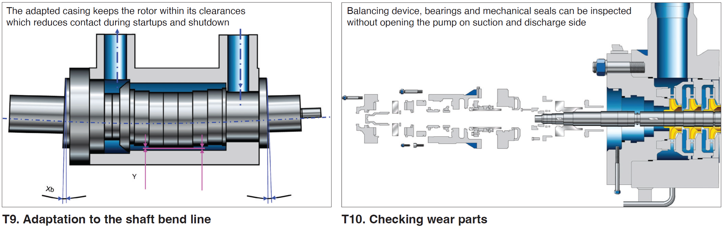

He followed with “gravity and sagging of rotors,” and adaptation to the shaft bend line (Fig T9).  “The adapted casing,” he said, “keeps the rotor within its clearances which reduces contact during startups and shutdown.”

For maintenance, in the samples shown, Fischer pointed out that all wear parts except casing wear rings are easy to access. This allows easy replacement of shaft seals, bearings, and balancing devices.
For checking wear parts during on-site maintenance (Fig T10), Fischer discussed:
  • Lube oil, cooling, vent and tapping piping removal.
  • Bearing removal.
  • Shaft gland and mechanical seal removal.
  • Rotor lifts to check internal clearances.
  • Removing casing nuts/lifting cover.
