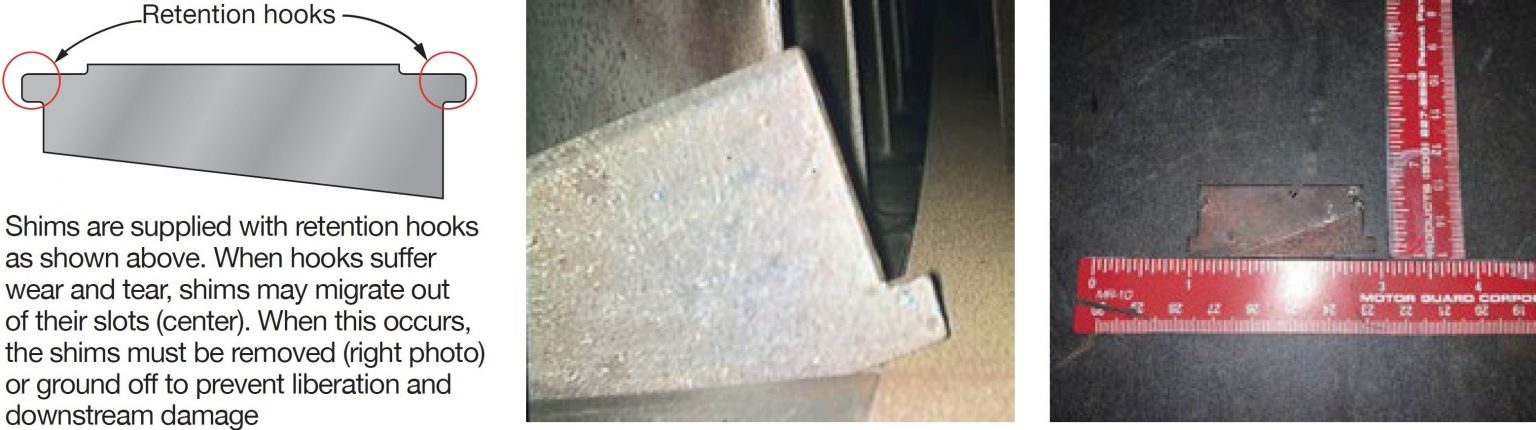

Update: A week ago, Mike Hoogsteden, Advanced Turbine Support’s director of field services, called to say the company’s technicians had removed in-situ a protruding shim in the 12th stage of a 7EA, saving the owner the more than $400k it would have cost to extract the shim had case removal been required.

Hoogsteden added that the protruding shim was located above the right case break (photos) and that the peaking unit had recorded about 8500 service hours and nearly 700 starts when the inspection was conducted. He suggested that O&M personnel new to the GE E-class fleet become familiar with TIL-1562, “E- and F-Class Shim Migration and Loss,” issued in January 2007. To dig deeper into the subject, consult the 7EA Users Group library on the Power Users website and meeting reports available in CCJ’s searchable archives at www.ccj-online.com.

Concerning shim migration, he adds that once a shim has migrated to approximately 50% of its height and is protruding into the air stream, the OEM no longer considers this a low-to-medium risk condition and it should be removed or blended flush.
