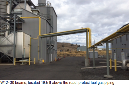

The road crossing was a main concern given the potential of something striking the overhead piping. A pair of W12X30 beams was installed on both sides of the piping, with the piping set well inside the protective structure (photo). The bottom elevation of the wide-flange beams has a clearance of 19.5 ft.
