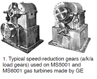

GE offered these two gas-turbine models requiring speed-reduction gearboxes to drive 2-pole ac generators (Fig1):
    • The MS5001 package power plant manufactured by the OEM in Schenectady from 1960 to the mid-1980s.
    • The MS6001 cogeneration engine also made in Schenectady—from 1978 to about 1988.
These plants had gas turbines operating at approximately 5100 rpm, with speed-reducing gearboxes driving generators at 3600 rpm. Good alignment of the gas turbine to the load gear was critical for vibration-free operation of driver and driven equipment at those speeds.

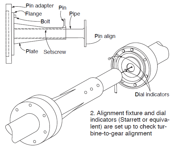

The skill requires the use of various dial indicators and the “how to” knowledge used during the original installation by a GE engineer. A tubular version of the alignment fixture (Fig 2) can be used with various dial indicators (Starrett or equivalent) to measure and establish the deliberate vertical offsets shown in GE technical publications.

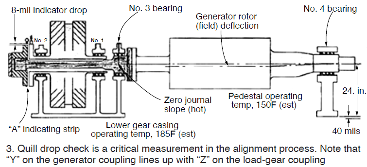

    • Proper loading of the common bearing shared by the load gear and generator rotor. This alignment is commonly known as the “quill drop” A shim under the generator pedestal bearing was chosen to assure the front-end weight-bearing of the generator rotor (field) rotor (bearing No. 3 in Fig 3). This may have to be changed to get the proper “drop.”
    • Bearing centralization for the generator rotor, as measured at the front of the load gear. This includes a “crank check” to assure the straightness of the quill shaft.
GE specifies the amount of vertical offset between the turbine and high-speed gear shaft flanges. Of course, the load coupling must be removed and the alignment fixture installed to accomplish this measurement. With the fixture attached to the turbine-end flange and dial indicators reading on the face and rim of the pinion-gear flange, the turbine should be lower than the gear by approximately 50 to 60 mils. That would be a total indicator runout (TIR) of 100 to 120 mils with the rim dial indicator initially set at zero at the top 12 o’clock position.

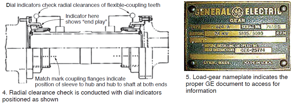

It is important that once the load coupling is installed after alignment, it not be internally bound. Radial clearance can be checked as shown in Fig 4.
GE provides data sheets and nameplates with the gas turbine. Example: In Fig 5, the nameplate indicates that information for the S-624-A reduction gear is in publication GEK-25774.

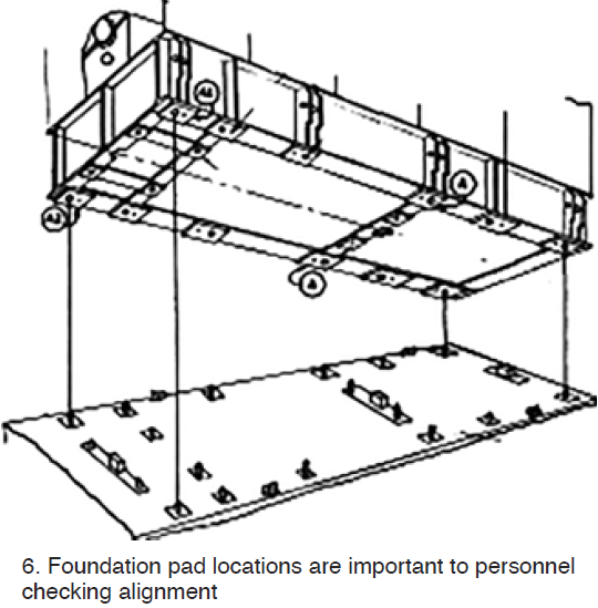

The generator foundation supports are shown in Fig 6. The calculated “move” takes into account the vertical and horizontal moves for all the pads, with shim changes required on each pad to achieve the “perfect” move. A well-trained engineer can follow the GE specifications to elevate the generator to the proper level using the principles of trigonometry and geometry learned in high school.
