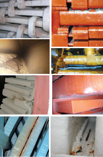

Clyde V Maughan of Maughan Generator Consultants published a paper in 2006 summarizing a survey of 200 case studies by end users on problems that have been detected on stator windings in motors and generators. Since then at least an equal number of problems have been found (table).
