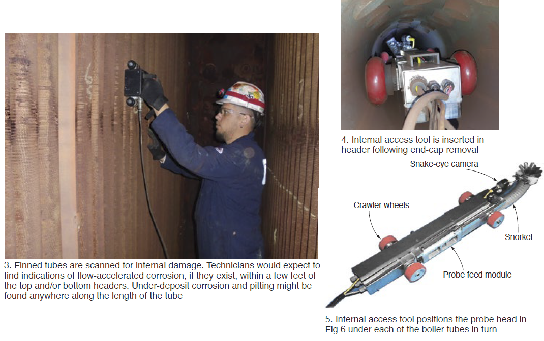

Tube-wall thinning. Using a proprietary Low-Frequency Electromagnetic Technique (LFET), TesTex technicians can examine HRSG finned tubes from the outside to detect and quantify internal pitting, wall thinning attributed to flow-accelerated corrosion, and under-deposit corrosion (Fig 3). Benefit of LFET is that access holes don’t have to be cut in the tubes to conduct an inspection.
TesTex’s Shawn Gowatski says LFET is very reliable for locating pits of ¼ in. diam and larger, and wall loss in excess of about 20% of the tube wall thickness. This type of damage typically is found in the economizer and back-pass sections of the HRSG, warning of impending issues that can be corrected before a forced outage might be required.

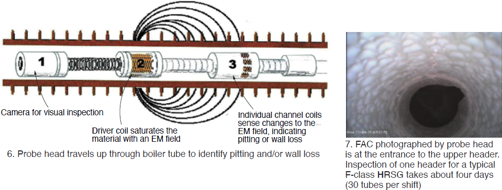

A more exacting inspection of tube internal condition is possible with TesTex’s Remote Field Electromagnetic Technique (RFET) using the internal access tool. The crawler (Figs 4 and 5) is inserted in either the upper or lower header after the end cap is removed and the RFET probe, equipped with a camera, is moved through individual tubes to detect wall thinning and make a video recording of the 360-deg internal surface. Probe travels at 2 to 3 in./sec (Figs 6, 7, and video). Current header-to-header tube-length limit is 70 ft. A benefit of using this tool is that it is able to examine the full lengths of all the tubes in a header.
