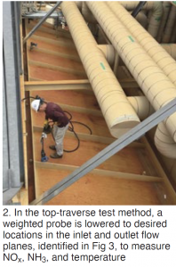

SCR Solutions LLC was engaged to help the plant determine the cause of the emissions excursion. Principal Consultant Bill Gretta, who specializes in SCR testing and optimization, and AIG (ammonia injection grid) tuning, began his investigation by gathering gas-path data at the catalyst inlet and outlet using the company’s proven top traverse method (Fig 2). Temperature and NOx were measured at 12 elevations via each of the HRSG’s seven roof ports (total of 84 data points), as shown in Fig 3.
Initial results revealed very high NOx (more than 10 ppm) at the SCR outlet in locations directly in line with the baffles separating the tube banks. Temperatures in those same locations exceeded 1000F when duct firing. By contrast, SCR outlet NOx readings in regions away from the baffles, where temperatures typically were about 740F, were generally less than 1 ppm.
