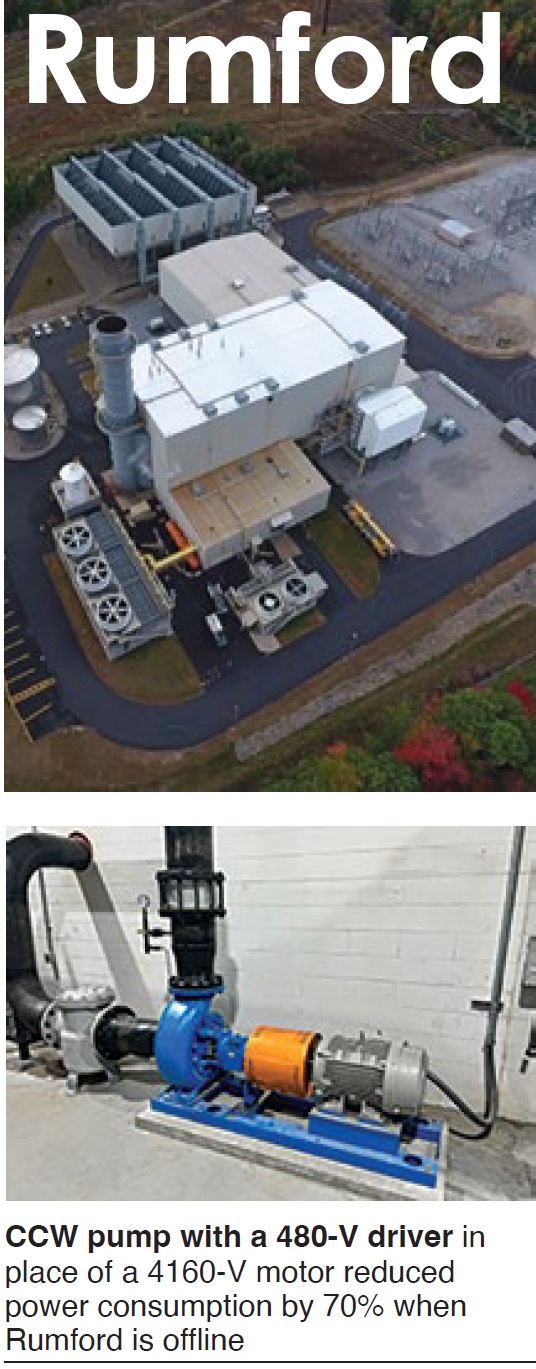

Personnel collaborated to find ways to reduce station service load when offline. Two promising ideas emerged: Use a smaller air compressor and smaller closed cooling water (CCW) pump to satisfy offline needs. The original CCW pump, designed for baseload operation, has a 4160-V motor; the proposed offline CCW pump, a 480-V motor.
Solution. Reduce the power bill by identifying efficiencies that could be gained plantwide and execute promising projects. Two systems targeted were the plant compressed-air and CCW systems. Both were oversized for the service required when the plant was not operating.
Looking first at plant air, calculations based on metered readings were made to determine the cost of running the existing compressors when the plant was not producing electricity. Seeing an opportunity for savings, staff investigated lower-capacity, more-efficient compressors to fulfill plant needs while it was offline.
Staff also saw the large power draw from the 4160-V CCW motor could be reduced by installing a smaller pump for offline use.
Results. Both projects were successful. The new, quieter, more-efficient, and lower-capacity 480-V air compressor for offline use reduced power consumption for compression by 20%. Payback on this portion of the project was originally calculated at just under five years.
The CCW mod proved even more beneficial. Use of the 480-V drive assembly while the plant is offline reduced power consumption by over 70%, resulting in an estimated payback of less than two years (photo).
